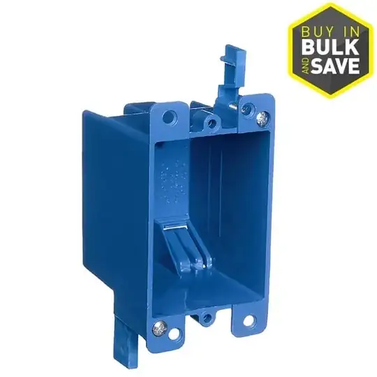

The answer is yes, a junction box needs to be supported by more than simply the cables going into it. But the bar isn't high. If you're working with drywall then mounting the box to the drywall itself is sufficient. The "old work box" exists for exactly this purpose. (image credit: lowes.com)
old work box

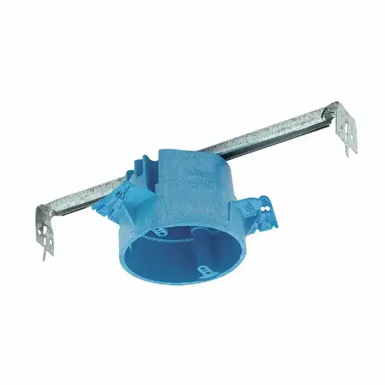

Another option is to use a box with a built-in spreader bar: these exist so that a box can be placed in just the right spot between framing members, like a light fixture that is to be centered in a certain location. (image: simsupply.com)
ceiling box
