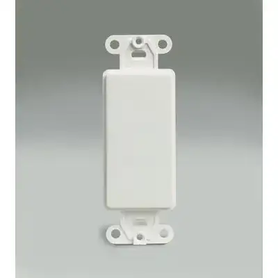

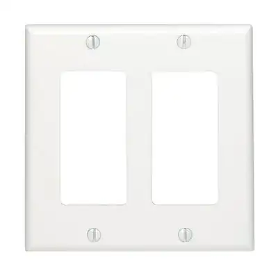

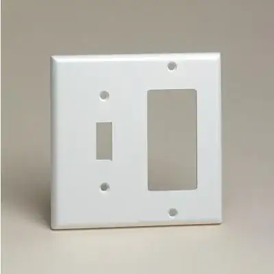

If you can't fix the problem at the plug, then remove the switch, connect the wires together with a wire nut, and then install a duplex faceplate with a blank. The only way I know of to do this is to use the "decora" style blanks, and then either a duplex decora plate, or a combination toggle/decora plate.
["decora" style blanks duplex decora plate combination toggle/decora plate
