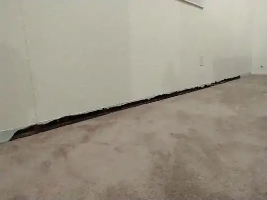

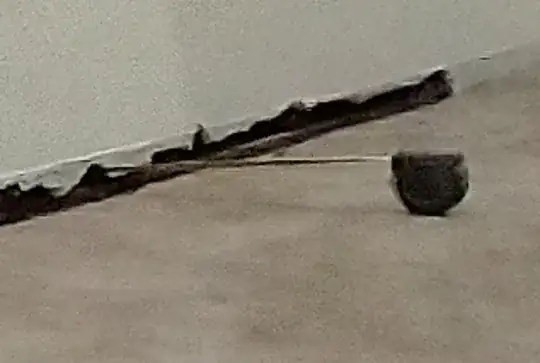

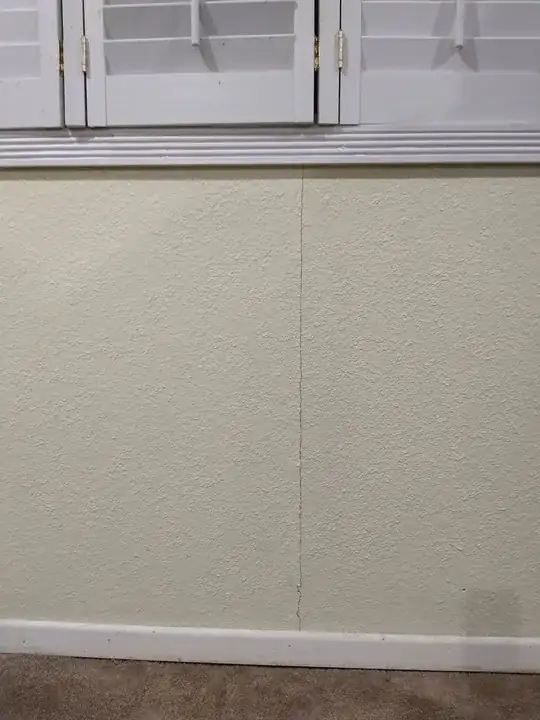

I noticed a vertical crack in the wall from the baseboard up to the window above it, Vertical crack was first sign of trouble so I pulled off the baseboard to investigate. I saw that the drywall under the baseboard had cracked and crumbled away in a few spots. I pulled off a chunk of the drywall (about the size of 2 or 3 fingers), and much to my surprise a handful of dirt/soil/earth came out! I then used a screwdriver to jab the drywall (just below the height of the baseboard) which easily crumbled and came loose. If it didn't break up easily I skipped ahead to try the next spot. I did this along the length of the wall and about ¾ of it had this problem. Drywall beneath molding had weakened and crumbled easily

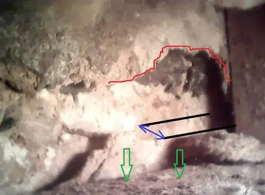

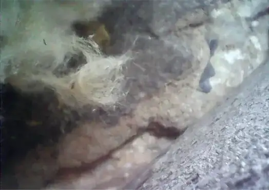

I then stuck an inspection camera inside the opening and mostly saw insulation. Where I was able have an unobstructed view, I could see lots of cracking. Inside the front wall of house.  Shows cracking which allowed dirt to enter wall I could also see outside light coming into the wall's interior when the room was darkened.

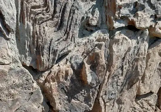

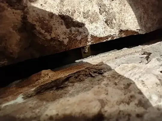

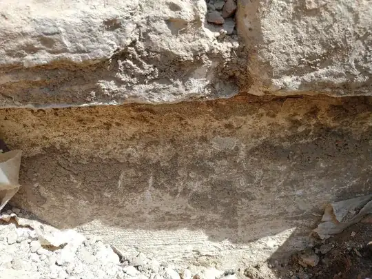

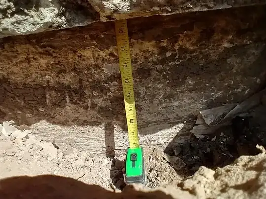

Next, I went outside to find the place where the light was entering the wall. I started by digging some of the ground away from the foundation down to about a foot. Dug some dirt away from foundation looking for a means for dirt to enter wall The concrete of the foundation appeared to be in good condition and did not reveal any cracking or any openings leading inside the house. close-up of exposed foundation as seen in previous photo, seems OK

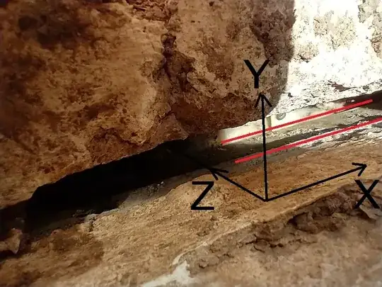

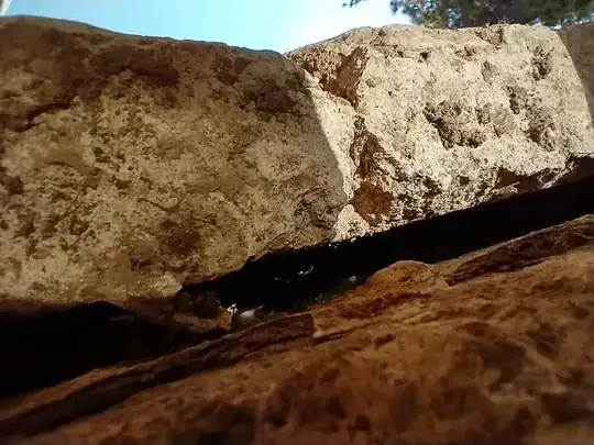

To find the light's point of entry which I saw from inside, I referenced a corner of the window to measure offsets down and along the wall to the problem area inside the house. I then used these measurements to measure from the same corner of the window on the outside of the house. The specified location was a point just above the boundary between the foundation and the facade of house. This was confusing at first because no deterioration was apparent. facade is free of holes or openings leading to inside of wall The reason was because although the surface of the facade was intact, it had separated from the rest of the house which could only be seen by looking upwards from the ground. gap between wall and facade as seen looking skyward from pit shown in photo 4 The tape measure would not be able to penetrate the gap between the facade and the wall were it not below the level of the ground and pointing skywards. tape measure shown extending up into gap behind facade

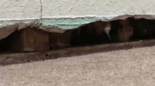

To verify that the point of entry on the inside of the wall actually exited the exterior wall at the indicated location, I was able to stick a tape measure into the wall from inside the house, tape measure shown penetrating wall to verify exit on exterior side of wall
and see it in the gap from outside the house. tape measure shown protruding into gap as seen from exterior side of wall This also was a way to measure the size of the gap (about ¾").

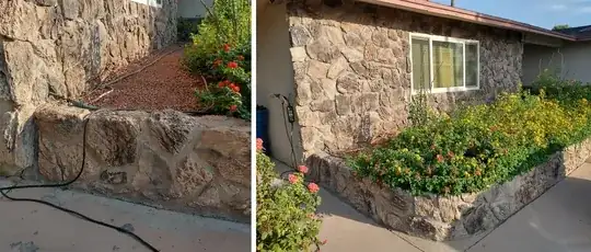

I think what I have learned is that the foundation of a house should always be above the level of the ground surrounding it. What has happened in this case is that this house had a 2-car garage which was remodeled into a master bedroom. Then the front wall of the garage-turned-into-bedroom had a giant flower bed built onto it (in the way you might see a flower box hanging outside of a window). garage remodeled into master-bedroom with giant flower bed built onto it The left side of the above photo show the same area as seen in photo #4, only from a slightly different angle and further back and after I filled in the hole. Photo #5 shows the foundation after I dug away some dirt, as well as the bottom of the (fake) stone facade. This is where the problem is because the foundation, facade and ground all meet at this level. This is why the dirt/soil/earth came out from behind the baseboard, because it was always right outside. The next photo gives photos# 7 & 10 some perspective from the XYZ axes I drew. (The ground is parallel to the XY plane.) perspective for photos# 7 &10 Also notice what is between the red lines. This is a 2x4 which lies flat on the foundation so you can see just where the foundation is/ends. Here is that same 2x4 as seen from inside the house: same 2x4 as seen in photo 12 When I look at photo# 3, I think it wasn't much help because, like, What is all that stuff? This one is hopefully better. enter image description here The red line is calling attention to the edge of something which I think is that black tar paper stuff used as a vapor barrier to block wetness. It is still attached to the vertical stud (to the right, from our perspective). You can tell, because the shadow cast onto it is very thin. The green arrows point to the stud from the previous photo. The black lines are meant to be parallel to each other and to the 2x4 (the ground). They represent the size of the gap (the facade separated from the house) and is equal to the blue arrow.

  • Drywall Crack - That is a likely the factory joint of the drywall. It cracks due to movement of the studs that can happen for a variety of reasons, including temperature, humidity changes and settling. Will crack more easily if it isn't properly taped and mudded. Fixing it properly requires cutting out the old tape, filling (I prefer elastomeric caulk) any gaps, redoing the tape & mud and any texture, repaint.
  • What causes the drywall to crumble like that - Water. As you have found you have a hole that has let in dirt and moisture (and likely insects). That water is likely what has caused the flex and moisture issues. That water could be coming from where you see the gap or it could have originated at the window (or higher)
  • Is it bad? Yes, very. Water, both suddenly and over time like this, is the worst thing that can happen to a house short of fully burning down. Insurance often won't cover damage caused by slow water intrusion like this (nor the insect or other damage that follows). It is critical to find the root issue and properly fix it. Hopefully it isn't a large fix, but any water intrusion is worthy of 'very bad' levels of concern.
  • Can you use foam and other patching to address it? - No. The hole is likely a symptom, not the issue. And it looks like the exterior wall isn't even on baseplate anymore. Also, Great Stuff open cell foam should never be used around moisture as open cell foam sucks it up if the skin is cracked. It is only good for air sealing in dry areas.
  • Recommendations:
    • As Mazura stated, it looks like your dirt is higher than the foundation. If that is the case, it needs to be dug out and regraded around this area.
    • You need to find the root of the water intrusion and determine the extent of the damage (how high is it, is the wall even on the foundation or has it flexed out, etc). Since you need to do drywall repair anyway, I'd recommend starting by cutting the drywall out under the window (along the middle of the stud take make it easier to attach a new piece of drywall). Remove the insulation, and see what you see. Test the outer sheathing with a screw driver to see if it sinks in, indicating rot. Being solid on the inside doesn't mean the outside hasn't started to rot but it will at least give you an idea of next steps without having to start tearing off the rocks on the outside.
