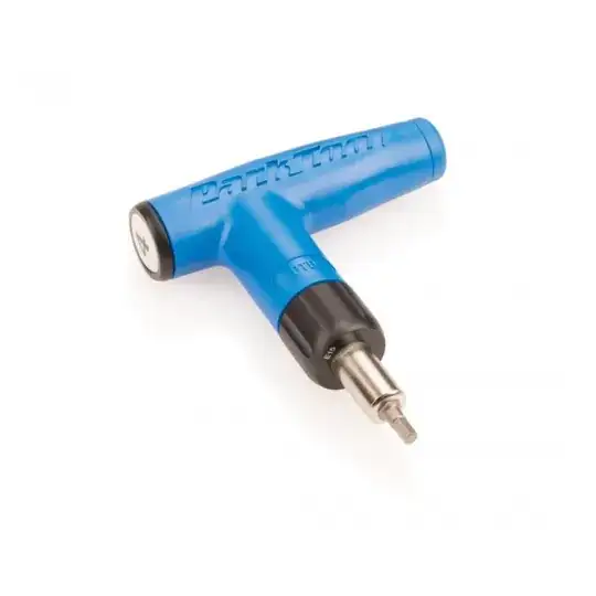

Simple is good. There are torque wrenches that have a fixed nominal setting, and if you're always working on the same values, then a hard-configured tool is one less thing to get wrong.
Downside of these is you need one for each torque setting you intend to use - if a fastener needs a higher torque you either need a larger one, an adjustable one, or "add some more torque" with a spanner/driver.
You can't just "lean on these harder" to go beyond the fixed setting.
Example, (from the cycling world) This one is 4Nm which is ~35 inch pounds: ""
