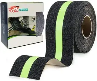

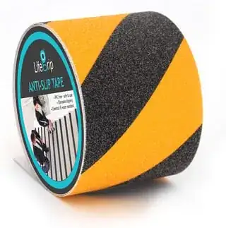

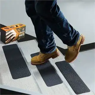

Slip resistant, waterproof and quiet: I would recommend stair tread grip tape. It also has the added benefit of not messing with riser heights at all.
Some examples (all courtesy of Amazon.com. No recommendation expressed or implied.)
Regular:
person in boots walking up stairs with grip tape
High visibility safety:
roll of yellow & black striped grip tape
Glow in the dark for even more safety:
Roll of grip tape with glow in the dark green stripe
