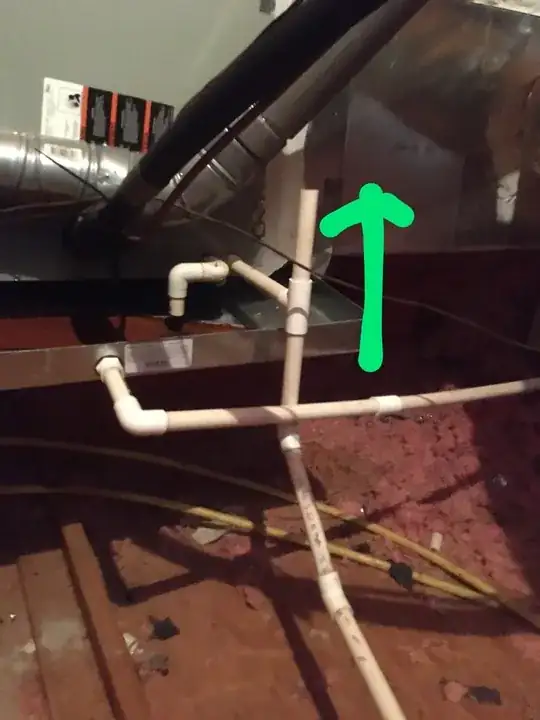

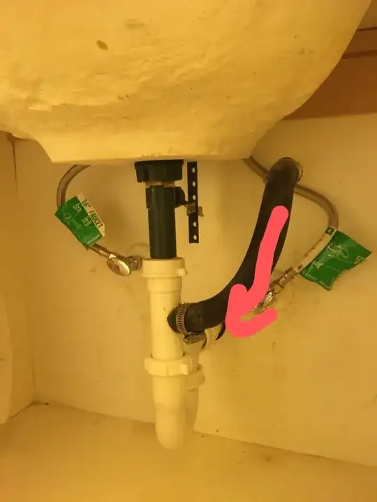

Update on 10/9/2021: I upload these two photos after reading the comments: one from AC, and one from vanity sink, I have confirmed following: When AC FAN is on, smell air is out from the black rubber connection (marked red). There is also air out from the pipe marked in green at AC in attic, but no odor.
I guess it does not matter if if there is a P trap next to AC for this problem, because the odor is not coming from AC vent. I do not know what is purpose of that black rubber connection and where it connect to, and how it is related to AC air flow.

Also the back rubber pipe is the drain from AC.

It's common (in some areas, including Dallas) for the AC condensate drain to be plumbed into a nearby bathroom drain. The drain tube for the AC is connected before the P-trap so sewer gasses can't make their way back into the AC unit. This also means that if air is blowing down the drain pipe, it will come out of the sink and cause an odor.
If this is new, then it could be a clogged AC filter or a collapsed air duct causing a higher-than-normal pressure in the air handler. Check that out, and see if everything is ok.
A permanent fix is to have an air-gap in the drain line next to the air conditioner. This allows air into the pipe for smooth draining, but in case of a positive pressure it would also allow air out instead of it being forced down into your vanity.

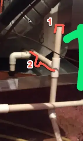

Eliminate or cap (1, shown) the unnecessary vent from the condensate line and add a trap (2, shown) to it. Together these will ensure that water, and not air, flow through it.
This is an A/C condensate trap that is transparent for easy inspection and includes ports for easy cleaning.
