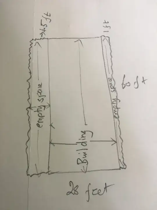

Building layout
  • I have empty ground on right and back side of building , as the ground is expensive I can't buy and use that as leech field
  • The building has 3 houses one in ground floor and two in upstairs so it's like 10 or more people living in the apartment at any given time and with number of people are more so the grey water. The grey water is coming from washing clothes/utensils,bath room etc..

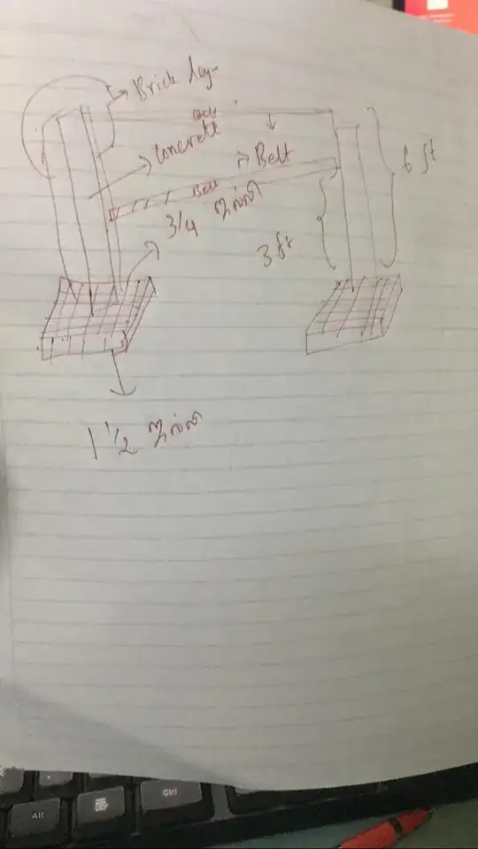

Here is my building foundation design
Building foundation design
  • I know RAFT foundation is best for any type of soil including saturated clay.
  • My ground soil seems to be either clay or saturated clay
  • I've asked for local professionals advice here are some suggestions from them this includes my own research as well

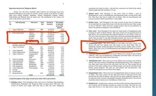

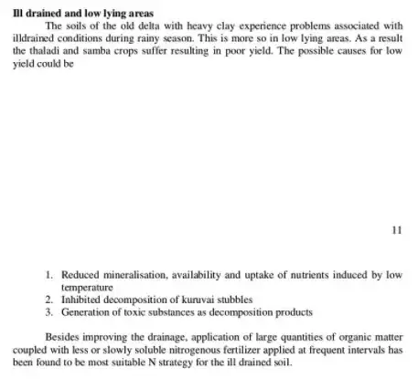

Please find my soil texture below
Reference for soil texture: https://www.yumpu.com/en/document/read/6730715/cauvery-delta-zone-status-paper-tnau

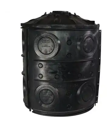

Try flow-well Drywall or try something like this. It should do.
So its basically a container with some slots so that water can be discharged at all the levels of sand. It's better and can contain more water than soak pit.
Reference:
https://www.ndspro.com/flo-well-kit.html
