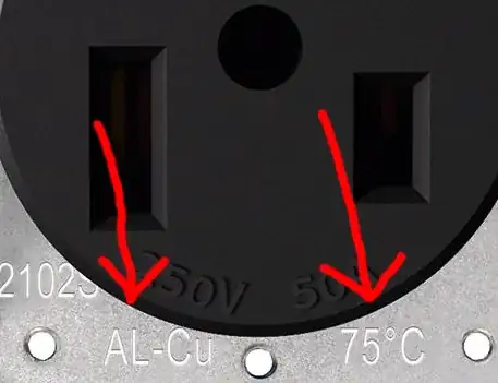

#2. Use a receptacle that is rated for 75C thermal, and aluminum. There is nothing wrong with aluminum wire at these larger sizes (#6 and larger).
Use Aluminum wire, AWG 6/2 or THHN or XHHW
This is rated for 50A if both terminals are 75C thermal rated (breakers are).

If you must use it for social reasons, you must a) run in conduit the entire way (no gaps) and b) follow my advice about getting a socket with 75C thermal rating. The circuit breakers are 75C. THWN-2 wire is good for 90C. You are limited by the lowest temperature, that being 60C unless the socket is 75C.
#8Cu and #6Al are allowed 40A at 60C.
#8Cu and #6Al are allowed 50A at 75C. <-- Bingo!
