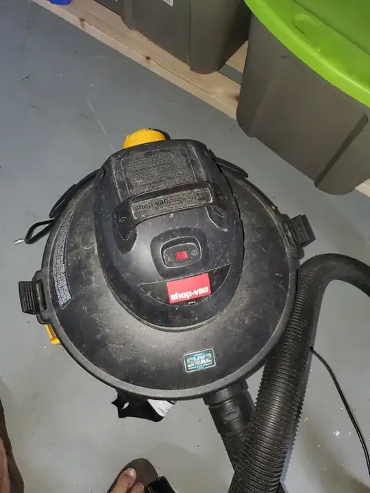

I have a previously-owned wet/dry ShopVac that I have only used for its wet mode (basement floods a lot). I now want to "switch it over" to its dry mode for the first time ever:

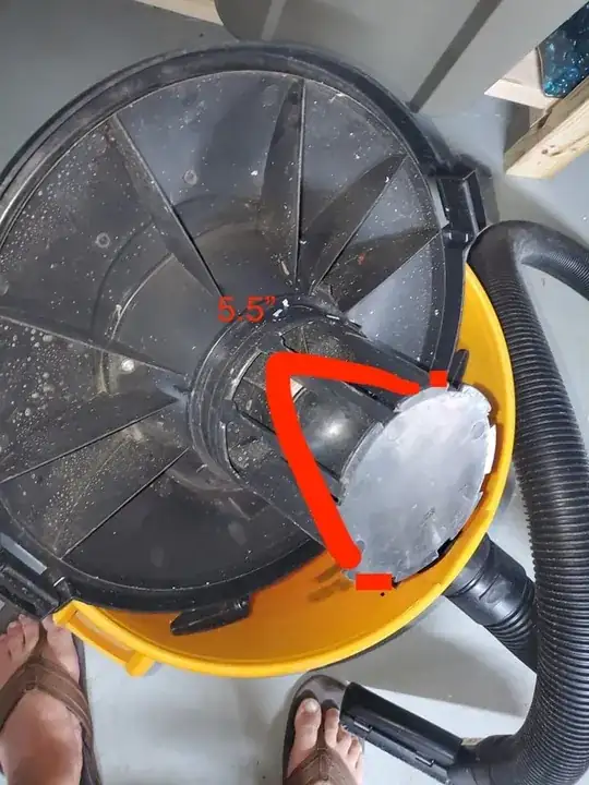

Not sure if it helps/matters, but the diameter of the black plastic protusion hanging down underneath the top-part is 5 1/2".
My question: what specific part(s) do I need to buy so that this will work in dry mode (and pick up debris and dust), and how do I install them?

Normally the only difference between wet and dry mode is a filter. Typical paper filters don't do well after getting wet so they need to be removed.
The only thing you should need is a new filter, and maybe a cap used to retain the filter. I've never had that exact brand so I'm not sure how the filter is held in place.
