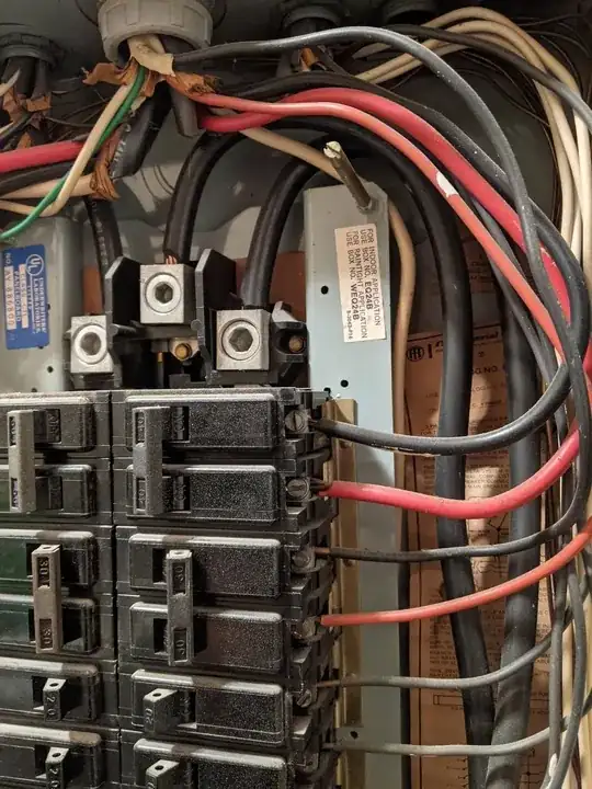

Existing circuit starts at the panel with two 30A breakers with handle ties. It's 10/3 wire with ground (black, red, white, ground). Black from one breaker, red from the other, neutral to the neutral bar, ground to the ground bar. As expected.
So I'm going to replace those 30A breakers with 20A breakers (with handle ties) and then in my circuits in the garage I'll be sharing the neutral (with pig-tails, not the device pass through). I think I also might just make this stupid easy and do a 2-gang box in the garage so there's just one destination for the existing wire. Neutrals go together, one outlet gets black hot, one gets red.
Anything I'm missing? Code wise I'm compliant?
Here's a photo of the current circuit from the panel perspective. The circuit in question is the two 30A breakers on the right side coming from the white wrapped wire in the middle KO (the breakers that are currently off).
Thanks!
Edit: Mistakenly labeled the original wiring as 12/3 with ground. It's actually 10/3. So additional question is can I leave the breakers as is? Maybe install 30A receptacles, or even just 20A receptacles and have the extra overhead...?

10 AWG wires (based on clarification in comments to the question) can handle up to 30A. The "usual" receptacles for most things in the US are 15A or 20A. There are exceptions (welders, EV chargers, etc.) but for most people it is 15A or 20A, generally 120V and occasionally 240V.
Installing 30A receptacles actually won't help because they will not be compatible with the things you want to plug in. That leaves two choices:
  • Replace the 30A double breaker with a 20A double breaker. That gives you a 20A MWBC (Multi-Wire Branch Circuit). With that, you can install a bunch of 20A (or 15A, but no advantage to doing that) receptacles.
  • Install a subpanel. This is more work and more parts (subpanel, breakers, etc.) but gives you more flexibility. In particular, a 30A panel could reasonably support 4 120V 20A circuits - 2 on each leg, and/or some 120V and 240V circuits. You couldn't run everything at once, but you could, for example, use two reasonable size power tools (e.g., a saw on one and a dust collector on the other) and still have separate circuits for lighting or smaller loads. But that subpanel is limited to 30A unless you can replace the cable with larger wires.
Either way, you need a double breaker (as you have) and not two separate breakers. That's because the cable has one neutral that is shared with the two hots. The only way around that is if you use one hot (black or red) + neutral (white) from the existing cable to connect to a single breaker and a single set of 20A receptacles on the other end, and then run a new 2-wire+ground cable to a second single breaker.
Since you still have a 240V circuit for the range, removing the 240V griddle circuit should not be a problem in terms of total circuits for the kitchen. Oops! As noted by J..., you are planning to move and/or repurpose both of your kitchen 240V circuits. You generally can't do that, as a kitchen should have at least one available. Personal example: I replaced by electric cooktop with a gas cooktop (i.e., went from 240V big circuit to standard 120V 20A circuit) but I still have a 240V big circuit for an electric oven (and upgraded that when I replaced single oven with double oven). It is quite common to use 240V for an oven even if you have gas for some cooking appliances, and I believe code requires you to have one such circuit available.
The 8 other circuits sounds high, but if you have 2 countertop (minimum, more is fine), 1 dishwasher (or 2), 1 disposal (or 2), lights, refrigerator, etc. it is easy to get to 8. Definitely don't move any of the 120V circuits to elsewhere without being sure there is no code restriction involved.
Any new circuits (and this is a new circuit because it is a new location) in a garage will need GFCI for the receptacles. That could be done using a GFCI breaker or using GFCI receptacles.

I know 8 circuits seems like an embarrassment of riches for a kitchen, but Code says you actually do need most of those.
The first question on converting either the range or griddle circuit is whether they have both a neutral and a ground wire. If they do not have both, they cannot be converted into what you want.
However if you do have ground and neutral, you can bring the wires out to a subpanel. Then you can run any number of 15-20A circuits off of the sub panel, and also support 240V tools as well.

To add a bit of info, there’s absolutely no harm in using that #10 wire directly to a 20A receptacle. Or even a 15A for that matter. As long as you downsize the breakers. The wire will just be oversized which is perfectly fine. The breaker’s primary function is to protect the wire. So, a 20A breaker with #10 is overly protected. Your proposed plan will be fine and NEC compliant.
