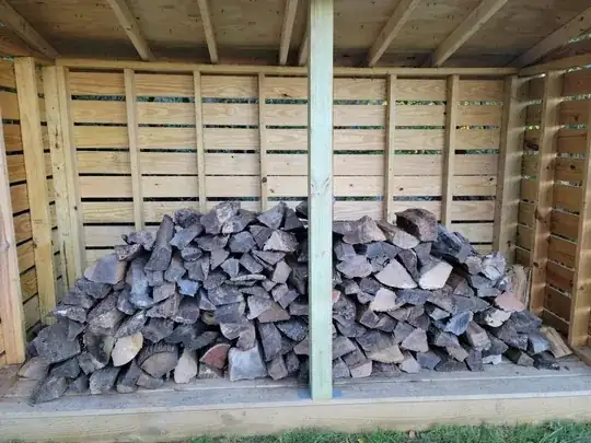

I have a somewhat simple wood shed built mostly of 2x4. On its own it seems sturdy enough. We had one guy at a time on the roof to put the shingles on and that felt reasonably safe. However, the walls are pretty easy to "flex" if force is applied to them. With wood loaded evenly on all sides it's actually sturdier, but I don't want to rely on that alone.

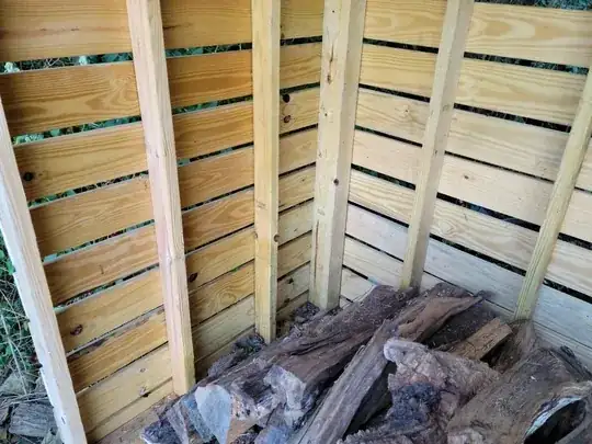

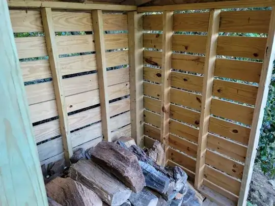

The sheathing that this wood shed has should be more than enough to act as cross bracing in order to prevent racking if the sheathing is installed properly.
If the sheathing is installed with a single screw or nail, that attachment point simply becomes a point around which everything pivots as lateral forces are applied to the walls.
Proper installation involves using two fasteners (screws have become my preference, nails are just fine) into at least two different studs for each of the horizontal boards. Ideally, there would be two fasteners through each board into each stud, however, if fasteners are limited, doubling up at the studs at the ends and in the middle of each horizontal board should be plenty sufficient to get you by.

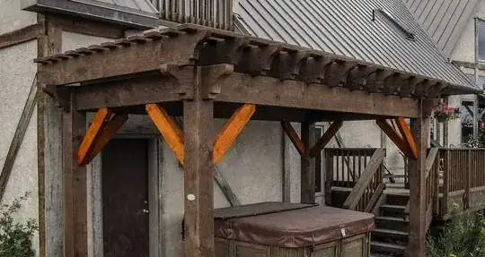

Cross braces at a 45 degree angle will strengthen the building.
Two on the back and one at each side. Can use 1x4s or whatever.
A couple of braces in the front from roof to front of the sides will also help. Can also use the centre post to add a couple more. About three feet down and three feet from side or centre post.
As building is now, there is not much to prevent swaying of back and sides.
Other idea would be to use cables and turnbuckles in place of wood.

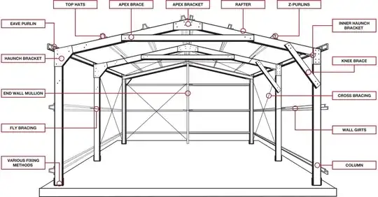

From https://www.sheds.co.nz/
Look in the upper right corner at "knee brace". Basically push on it to see what's moving, and then break up the rectangles into triangles by adding braces.

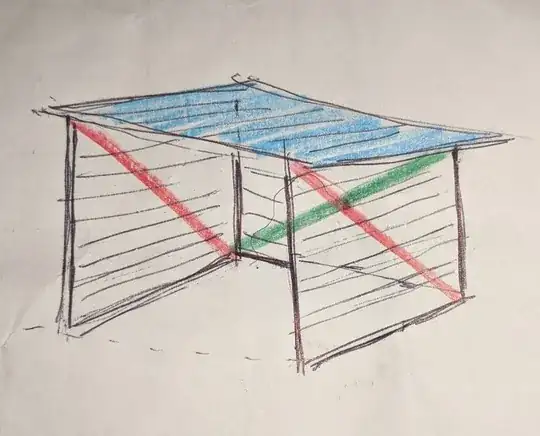

To add to crip659's answer, three braces are enough. The red lines show where you should place 1x4 braces on the side walls, and the green line shows one on the back wall. The braces should preferrably be nailed to the inside of the framing rather than to the sheathing. Your roof is practically incompressible; if you keep its back two corners stiff you will not need to worry about the front two. This layout makes the triangles as big as possible.
Note that for this brace layout, you need to use stiff members for the braces, as they will resist tension and compression. If you use something "floppy", like cable, you need to make an X shape on each wall except the front.
Ideally, for bracing, think about how to make triangles with as long of "legs" as possible, hopefully even from corner to corner of every rectangle. This is already done in the case of the roof sheeting, if the edges are properly nailed.
