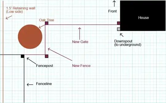

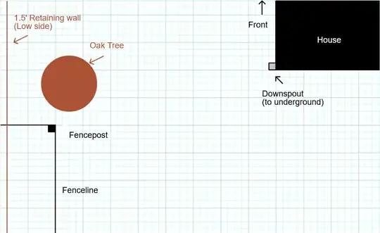

Here's what I was able to whip up as a rough drawing (thanks to Virtual-Graph-Paper.com). Each major graph block is about 1' x 1'.
I want to run from my neighbor's fence to the side of my house, but there's some layout issues. If I run straight across from where his fence starts, that would run to my back deck, not the side of my house. So I'm either going to need to run this at an angle to hit the back of my house (I made a rough measurement of 19 degrees), or jog around the tree on my side of the property line. Doing that at right angles would obviously require buying extra fence posts, creating 2 small fence bits with a run of 1-2 feet. Also, both of those posts would have to get sunk near said Oak tree, which of course is liable to have roots in the way.
My wife (sharper than I) suggested I just run the fence (and gate) at the angle to our house, straight to the existing fencepost. I'm wondering if that's a reasonable thing to do. It seems far and away the simplest (and cheapest!), but I can't remember ever seeing anyone with an angled fence line to their house for their back yard. I'm worried there may be a good reason for that I don't know about.
So I guess the basic question here is: Is there a problem having the facing fenceline to the back yard at an angle. I should add that as a design goal, I'd also like to maximize possible clearance width in my gate, so the fence won't have to be taken down again.

Based on the added drawings, I see no drawbacks to either method of installing the gate.
Having angled sections does make it a bit more challenging to get the fence rail appropriately attached, but if you've got a miter saw (either powered or hand), or even just a hand saw, you can cut the fence rails at the proper angle to join up to the posts.*
The one recommendation I'd make is to combine the drawings just a bit.
  • Locate the post by the tree per your first drawing so you have a simple 90° join to the neighbor's fence.
    • By not having any sort of odd angle when attaching to the neighbor's fence post, you won't have to worry about anything more than a few screws into his post. Nice and simple.
  • Make the angle a little steeper between the house and the relocated "middle" post.
    • This post is entirely your property, so if you need to notch it some to help with the join, you're free to do so without having to run it past the neighbor.
    • As an added bonus, this will give slightly more room between the tree and house if you ever need to get another large vehicle into the back yard.
  • When setting the post by your house, set it so it is 90° to the gate, not to the house.
    • This will eliminate another "weird" angle for attaching the gate to the post.
    • If, using a post just set on the ground for a visual, you don't like the look of a 4x4 set at an angle by the house, invest in a 4x6" post. Set the 4" side 90° to the gate, then mark & cut a bevel to make the other side "square" to the house. Of course, lumber is a bit spendy these days, so it's up to you to determine if the extra cost is worth the improved look.
