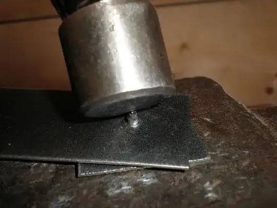

You can make a rivet out of a nail using a hammer.
https://www.instructables.com/How-to-peen-a-rivet/
peen a rivet
Pretty slick! Make hole thru sheets. Put nail thru hole. Cut off excess nail. Beat the rest down flat against hard flat thing, using flat side of hammer. Finish with ball side of hammer. I have some shiny brass nails I found in a dumpster that would love to be part of a project like this.
This is what that ball peen hammer you got from your grandfather has been waiting to do for the last 50 years! That is how it got its name!

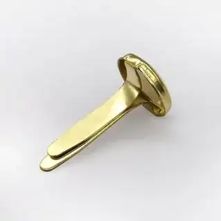

Brass paper fastener.
brass fastener
Get some with the longest legs you can find. Put thru minimal slit in cardboard. Then flatten open legs against the far side, glue them and clamp them overnight.
The surface area of the legs and the glue will spread out the area needing to support your attachment. The brass will look good with your hinge. It might still pull thru cardboard but is at less risk than a rivet because of the greater surface area.
Consider augmenting the back of the cardboard by gluing down something firmer than cardboard. I would use a cap from a jar. You could cut a piece of plastic.
