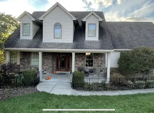

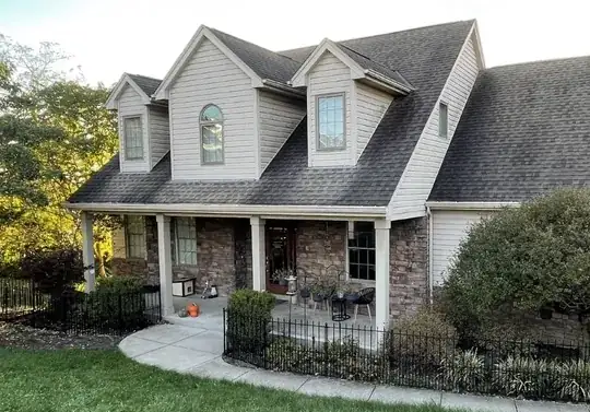

I am now exploring the possibility of enclosing the front porch of our house with top to bottom windows, to create a sunroom in modern style. The porch is a thick slab and the roof is enclosed as well.
There are outlets in the ceiling as well as lights so the electrical part would be relatively easy.
I will likely be making this the insulated area with the possibly a split air heat pump to be used as needed. I will run electric for it from the side of my house where my shut off is located in the floor below (basement).
I am looking for advise on sourcing the materials. Windows, doors, floor finish. On the floor finish, I’ve been told that porcelain is the only thing that won’t Crack.
One other consideration is that this is the front of the house. How atypical is it for the front entrance be to sunroom? Anything I need to watch out for? Any good places to start as far as installing windows and the door, or should I sub this to the window company? How much should I expect to pay for windows and doors? Any advise at this exploratory stage is appreciated.
Finally, posting photos of the exterior, as well as the photos of the look we are going for.

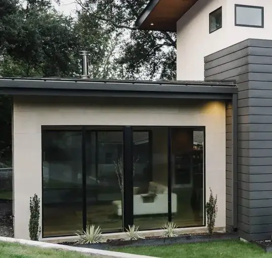

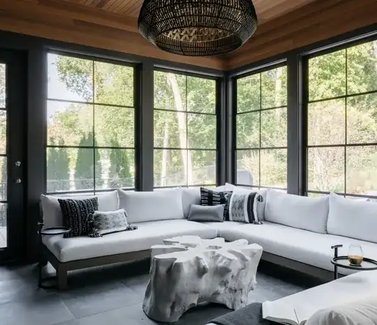

The look I am going for

I’d check the structural adequacy of the porch. Many porches flex when you walk on them. However, your new floor surface cannot flex or it will crack.
Normal porches are designed to 1/240 deflection, interior rooms are designed to 1/360 and tile floors should be designed to 1/640 or higher.
