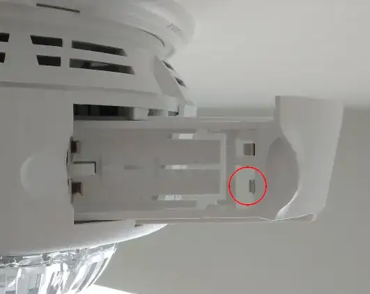

The problem was that, when I initially removed the old batteries, I damaged one of the terminals within the battery drawer. All the terminals are thin metal plates that deform easily; there are no spring terminals.
When I repeated the steps described above but bent the terminal back into shape before inserting new batteries (between steps 4 and 5), the detector stopped emitting the low battery warning.
For reference, here's a photo of the damaged terminal:
Battery drawer with a damaged terminal

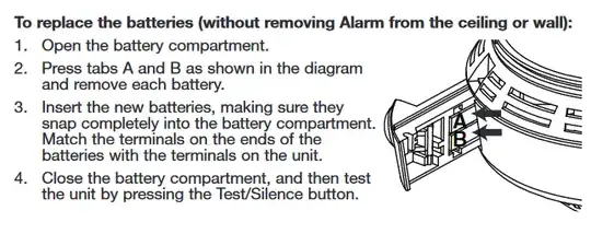

I damaged the terminal because the batteries fit very snugly within the battery drawer and I wasn't aware that they're supposed to be removed by pushing on plastic tabs on the back of the drawer. After being unable to remove them by hand I pried them out with a screwdriver, which damaged the terminal.
Use of the tabs to remove the batteries is described in the manual (excerpt below), but I didn't have a copy of it until I found it online later.
Manual excerpt describing battery removal
