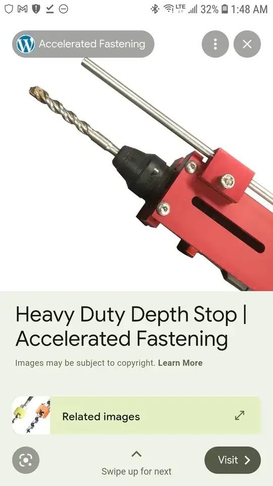

Get a drill with a depth limiting adjusterenter image description here
