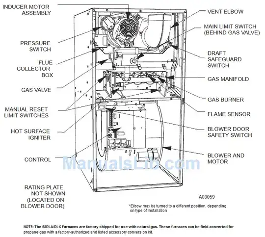

A diagram from a manual offered at manualslib.com shows the approximate location of the flame sensor. You could remove the sensor, clean it and its mounting location and hardware, and see what happens next.

parts location diagram

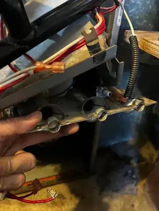

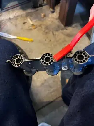

I figured it out. If only the first burner that is connected to the igniter fires up but none of the other burners light, and then the furnace shuts down and retries, the culprit is most likely either,
  1. Clogged flame spreader wings on the burners.
  2. Low gas pressure set on the gas valve.
My issue was rust on the flame spreader wings on the burner assembly that prevented all the burners to fire up. That's what caused the Ignition Proving Failure (code 34) and subsequent Ignition Lockout (code 14) LED error. I had to remove the burner assembly and clean the flame spreader wings with a wire brush.
If you have the same issue where not all the burners fire up, try cleaning the flame spreader wings before replacing the flame sensor.
Here are some photos (click to enlarge):
