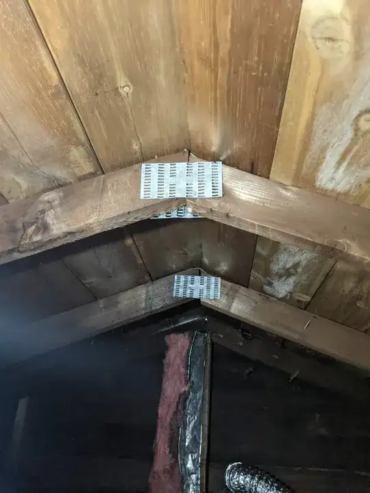

I recently bought a house and discovered that the rafters in the attic are separating from the ceiling. The roof does not seem to be sagging, and only the rafters on one side of the attic are separating. The rafters on the other side are fine.
Does anyone know why this is happening and how to fix it? Can I lift the rafters back into place? Thank you in advance.

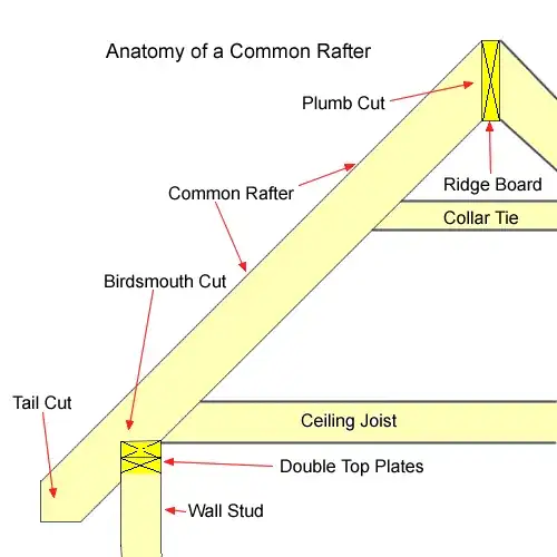

Your roof is missing a collar tie (very important) and a ridge board (less important).
In essence you need to pull your rafters back into triangle shape and install a collar tie. You cannot just lift the problem areas; your walls have likely bowed outwards. You need to bring it back into a tight triangle shape.
Anatomy of a common rafter

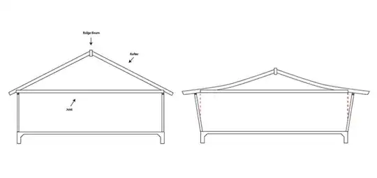

This picture shows you how gravity affects a roof.
Side walls of house being pushed out due to lack of collar tie

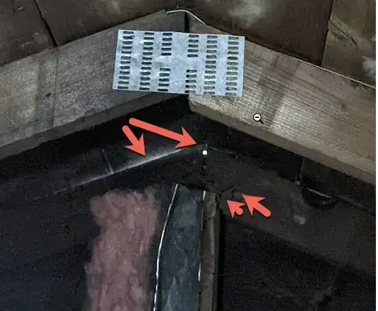

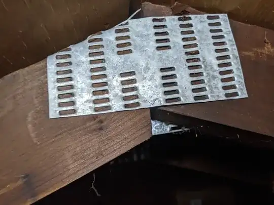

You say your roof isn't sagging, but there is some kind of disintegration going on that you need to have looked at by an engineer. Maybe there is more than just poor roof construction. Some of the apparent movement may be caused by subsidence in the supporting walls.
The last pair of rafters are prevented from moving with the rest by their attachment to the gable wall. So there you can see separation of the roof from the rafters, light coming in through that separation, separation of the rafters from each other, and a crack in the right rafter opening up where the end bit of it is prevented by the vertical support from moving with the rest.

As an unsupported roof sags, it can push the walls out from the vertical as it drops.
Imagine a roof as a simple inverted V thus rather than a correctly-braced A. If you push down on the top the sides have no option but to spread out - pushing the wall with it.
Depending on how far this has all managed to move over the years, you may have to consider pulling the walls back in as part of the process.
