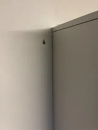

My holes are now too big in the stud I was going to use to hang up my ikea cabinet. What options do I have to still try to use that location? I needed to have it I installed there because my other cabinet is right next to it.
I was thinking of using wooden dowel/toothpicks to plug the hole but I don’t think it would be strong enough to hold my cabinet.
hole in drywall where screw was mounted

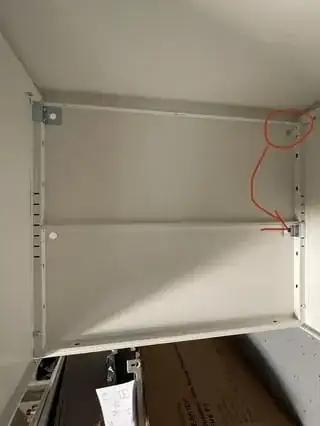

Update: this is a BROR cabinet so it’s a steel material. Here’s a photo of the back. I was going to use the bottom set of holes to attach to the wall. Is it ok to do that? I only plan on keeping lighter weight stuff in it (paper towels, etc) so additional 15-20 lbs at most.
inside of back of cabinet

I would be considering two options:
  1. using larger screws into the stud.
  2. gluing a dowel into the hole in the stud, even drilling out the hole to 6mm or 8mm and then, once the glue is dried drilling a pilot hole for the new screws.
For me Option 2 is my preferred choice.

Based on the second image posted and the updated description:
I would not rely on just the bottom hole on one side of the cabinet. The cabinet acts as a lever trying to pull the screw out of the wall. The lower the screw is, the longer the lever pulling against it. At the top, you've got a very short lever arm and not as much force, lower down, you've got a longer arm and thus more force. I'd suggest using both top & bottom holes.
Since the back of the cabinet is steel you can easily drill a new hole through it near the existing hole, then drive your screw through the new hole and directly into the stud. I would move the mounting bracket down to meet the new hole. Since the bracket is also designed to screw into the side rail of the cabinet, I would use the holes in the bracket as a template to drill new holes into the side rail of the cabinet and screw it in its new, lower position.
Since your screw snapped, you'll need to get new screws. I suggest that you get "cabinet" screws. They are designed for holding well in wood and have a built-in washer to help spread the load across the back of the cabinet wall instead of just the small point of a "regular" screw head.
Also, you mention "only" storing a few light items up to 10KG in this cabinet. That's all well and good until you forget and start loading it up with dishes, or run out of space and need to put some liquids up there, or you move out and the next person doesn't know you've done a rubbish job of installing the cabinet. If you're going to do this, DO IT RIGHT!

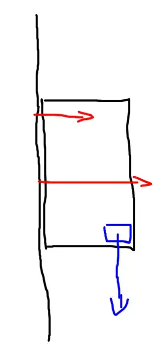

If you use the middle set of holes instead of the top one, traction load on the screw (red) will be about double with the same weight in the cupboard( blue). That's due to leverage.

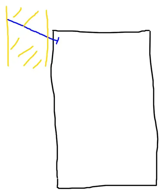

How about just driving the screw into the stud at an angle to dodge the damage done by the previous accident?

Why would you have to use the same fixing place? Follow the stud, and screw in at least 2" away from that hole!
