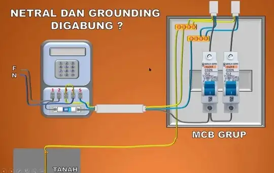

Edit2: I found some info on Youtube which seemed fairly credible, and checked my own meter. https://www.youtube.com/watch?v=ImdN08dHiYQ
This is the diagram on YT
You can see there are five terminals.

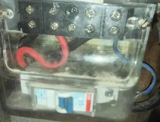

Here is my meter:
The labels are not clear in my photo but they are printed on the connector: 1 (phase in), 2 (phase out), ⏚, 3 (neutral in), 4 (neutral out). So the bottom ⏚ screw is supposed to be connected to a ground rod, but there was never one installed, and then the top ⏚ is supposed to bond to the top screw of neutral in.
Now, according to the video if the ground had been bonded at the meter (which is impossible as no ground exists there), then if I additionally bond at the consumer unit, this would cause the tamper detection on the meter to trip and it would stop working.
In this case where there is no connection between ground and earth at the meter, then the video suggests that if we instead bond at the consumer unit, then if the neighbour has a current leakage then that can make its way to ground at our consumer unit, and be read by our meter. For this reason it is recommended to ground at the meter.

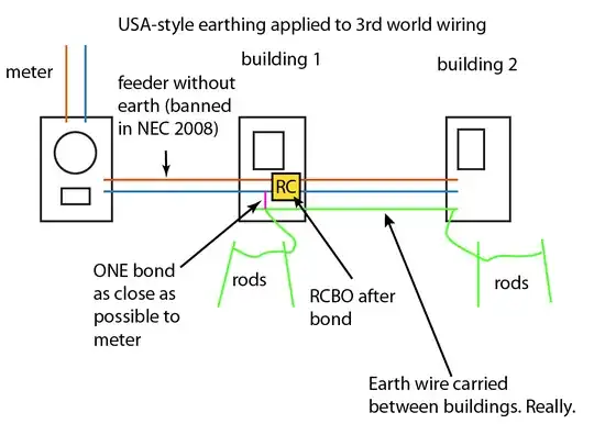

When you're spread out on a property like an American homestead, I recommend the American viewpoint of earthing:
  • An earth wire (green or yellow/green or bare) is carried to all buildings and all connected
  • Every building gets its own competent system of earthing rods - typically two 2.5m rods placed at least 2m apart (preferably opposite corners of building)
  • The earthing rods are bound to the earth wire at each building, in that building's panel/consumer unit
And then, the most important part: There must be only one earth-neutral connection. If you had two, then neutral current would detour via the earthing system. Generally we put this at the first disconnect point past the electric meter. However in an installation where there is a long feeder from the meter and that does not have an earth wire, we put this at the first place there is an earth wire.
The neutral-earth bond cannot be on the protected side of the RCBO! (that will instantly cause it to trip). So the RCBO must be "downstream" of the one neutral-earth bond.
The Youtube diagram shows the neutral bond at the meter (between 3 and 4) which is viable. Note the diagram shows a plain circuit breaker. If it were an RCBO, the neutral wire would be routed via the RCBO.
If you do not have an earth wire between meter and first building, then you will need to do something like this.
