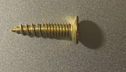

I changed a deadbolt lock on my front door, and in the pile of old parts, there was a weird screw with 8-32 threads near the head and wood threads at the end. I'm just curious:
  • what is the name for this type of screw?
  • what is it used for?
thanks

That makes a lot of sense to me. The 8-32 threads would hold securely in the metal frame of the lock mechanism itself, while the wood screw portion is just small enough to slide through the metal part and then be able to bite into the door frame.
If you used a simple wood screw then it would just slide through the metal part but not actually "hold" to it, so it would not be as secure unless tightened really well. This combination screw is not, in my opinion, a cost-cutting measure, but rather increases holding power, and therefore security. Which is the point of a lock.
In a little (Google...) research, I found a lot of double-ended screws without a head. Those appear to be either "one screw to work either way you need it" (cost-cutting by supplying one part instead of two) or for connecting two dissimilar items - e.g., a cabinet knob (machine screw) to a cabinet door (wood screw). But my hunch for this example, with a head and used with a lock, is a different functional purpose.

First, you don't want to have screw threads on the latch assembly (the outer of the two things you are screwing together). Otherwise it may bottom out on the latch assembly before it is screwed all the way into the wood!
In my observation, this is a "universal"/compromise screw that is designed to be usable in a wooden door... but also usable in a fabricated metal door which has tapped locations for the latch to mount.
If anything I'd call it weaker, as the machine thread will have extremely poor purchase in a softwood door. I would much rather use a proper wood screw that is wood its whole way. On a metal door these are as good as any brass machine screw of the same length of machine thread.

The same screws are intended to be used to attach the strike plate hardware to both wooden and metal door frames.
I'm not sure why the manufacturer(s) are doing this. Perhaps so that they can include only one pair of screws instead of two or more pairs for use with different materials. It may be a cost-cutting decision or just something intended to make installation easier.
