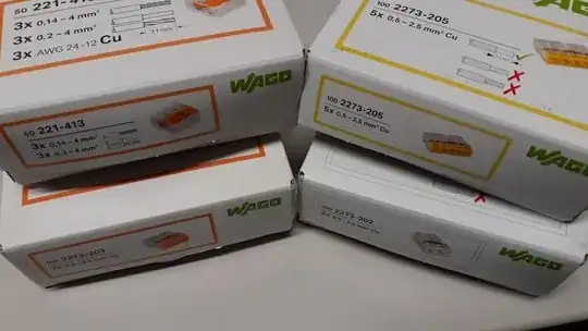

Aside: your question says "reusable" but the Wago 2273 series push-ins in your photo are not reusable. The Wago 221 series lever nuts are reusable. The next guy inside this j-box will likely be me, so make his life a little better by using a Wago lever nut.

#4. Ignorance of lever nuts improvements
  • No colors! One nut works on wire gages AWG #12-24.
  • Joins braided and solid reliably.
  • Visual confirmation that every wire is fully captured.
  • Installs on a single wire. Pop a lever nut onto the feeder and now there's no exposed hot.
  • Test port for meter probes.
  • They don't kink, twist, bend, or fatigue the wires.
  • You can easily add or remove one wire.
  • They nest flat.
  • Can be installed one handed. This is salvation when standing on a ladder holding up a fixture with the other hand.
  • You can get them onto really short wires.
