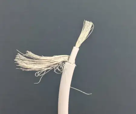

How would one solder, or in general patch, these two pieces of the same cable? Can I just separate the inner from the outer cable, solder and properly isolate one from the other?

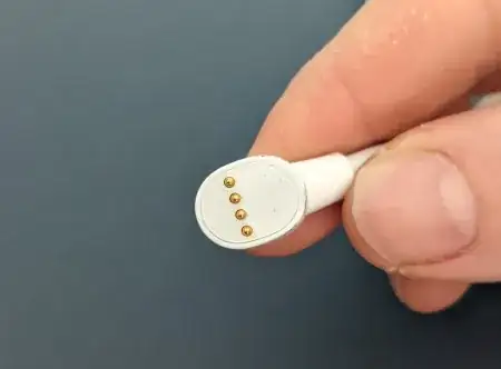

I bought a power cable for Google Nest camera but it won't fit my cable duct. I wanted to insert the probe through the duct, bind it to the front (charging part) of the cable
Charging end
While the end barely fits the duct, I tried pulling and the bond between cable and probe was too thick. I tried to bind the charging tip to the front of the probe and push, but eventually it could't make a tiny turn.

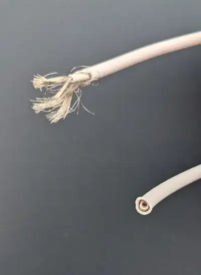

So after countless attempts I decided to cut it open to see if it was something like of a twisted pair, which is easier to solder. And found this.
While this cable is technically "co-axial" because the two conductors share the same center, this is not RF signal cable that we commonly call coax, and it doesn't have the same restrictions.
This cable isn't sheilded and doesn't have any special electrical properties. Its just two conductors carrying power and can be soldered like any other two conductor speaker or power wire. The only reason it is coaxial is so the final cable is round and not flat like a typical "side by side" power cable - just for looks.

If you're thinking of soldering it, then buy some heat-shrink tubing in different sizes.
If you make a reasonably neat joint, you can slide some heat shrink over the join, and shrink it in place. But remember to slide the tubing onto the cable before you do the solder joint. For a coaxial cable, that means sliding piece of thin tube over the inner joint, and a longer piece over the outside of the cable, before doing any soldering.
