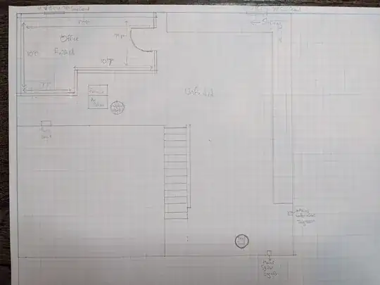

I am looking to create a finished space in my basement. The plans are for a habitable room within my basement (non-sleeping) to be used as an office. The plans exceed horizontal width requirements, and the ceiling exceeds 7ft. Contained within the room is a 32 x 15.5 inch egress window that was one of two such egresses installed original to the house. I have attached a rough drawing of the proposed layout.proposed plan
However, my plans were sent back to me by the local planning office (I'm in Western NY) as needing to be modified due to being out of compliance with the following code rules of the 2018 IRC:

To the best of my understanding, my plans as they stand should comply so long as:
  • I have mechanical ventilation installed in the new room in accordance with M1505
  • Lighting that conforms to the standards laid out in Exception 2 of R303.1
  • A ceiling height that conforms to, or exceeds, the height minimum set out in R305.1 (which I do, ceiling height is 7ft 10")
Because I have another egress window in the basement and mechanical ventilation system installed, I meet exception 1 of R303.1, and because I plan to install lighting that will meet the standards of Exception 2 of R303.1, which to me indicates that the egress window in the proposed office space is not required.
However, given that the window is indeed there already, must this window conform to R303.1 simply by existing? Can I meet the requirements of exceptions 1 and 2, but still have the window in place, meaning it is not a code consideration?
This is my best understanding of it as it is worded, however I wanted to get some additional opinions.
Thanks.
Update 1: The building inspector got back to me and confirmed that the window would be taken out of consideration for compliance if Exceptions 1 and 2 were met, however I would need to accommodate a means to get fresh air into the habitable space given the lack of an openable window as far as the inspection would be concerned. A fresh air mixing box attached to the air return would be deemed acceptable in this case.

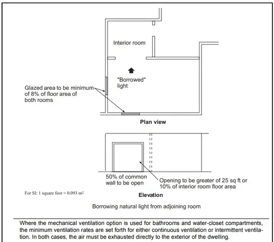

2018 IRC R303.1 Code Text: Habitable rooms shall have an aggregate glazing area (total) of not less than 8 percent of the (total) floor area of such rooms. Natural ventilation shall be through windows, skylights, doors, louvers or other approved openings to the outdoor air. The openable area to the outdoors shall be not less than 4 percent of the floor area being ventilated. Exceptions allow the use of artificial light and mechanical ventilation.
A notable warning from a web source:
Remodeler: if you have an existing home and you add a sleeping room, or finish a separate living space in the basement, the code requires that you install an egress window to serve these spaces. Without a means of egress, these rooms can represent a dangerous fire trap if you do not have a quick and easy to operate emergency egress escape window. If you have a basement that has a bedroom, recreation room, den, family room, media room, office, or home gym. All of these rooms are required to have a means of egress.
Comments:
So, appraently you are facing two issues here:
  1. Do you have glazed area totaling 8% of the entire floor area, as the addition of the office space classifys the entire basement as a "hibitable space", which more restrict rules apply.
  2. Following the same line, does the "hibitable spaces" meeting the requirement of code section R310.1 that says:
Basements, habitable attics and every sleeping room shall have not less than one operable emergency escape and rescue opening. Where basements contain one or more sleeping rooms, an emergency escape and rescue opening shall be required in each sleeping room. Emergency escape and rescue openings shall open directly into a public way, or to a yard or court that opens to a public way.
If I didn't make mistake, the existing window does not meet the code definition of an escape/rescue window, which requires:
  • The bottom of the egress window opening can't exceed 44" from the finished floor. (As noted, your window is 78" from the floor)
  • The minimum opening area of the egress window is 5.7 square feet. (The area of the 32"(W)x15.5(H)" window is 3.47 square feet)
  • The minimum egress window opening height is 24" high. (Your window height is 15.5")
  • The minimum egress window opening is 20" wide.
  • The egress window must have a glass area of not less than 8% of the total floor area of room(s) for which it is servicing, to allow the minimum amount of sufficient natural light. *
  • The egress window must have a opening area of not less than 4% of the total floor area of room(s) for which it is servicing, to allow the minimum amount of natural ventilation. (*)
(*) Multiple windows can be used to service a single area where one window does not meet these percentages of total floor area. As long as the totaled amounts from this combination of windows meet or exceed the 8% for natural light and 4% for natural ventilation.
Conclusion:
  1. You need to have a gross (aggregate) glazed area that is at least equal to 8% of the entire floor area. If a glazed window is installed in the office space, it can be a fixed pan window if meets "Exception 1"; if the requirement of a glazed area in the room is waived per "Exception 2", you have to make sure the totaling of the glazed area in other space(s) meets the 8% requirement.
  2. You need to make sure you have at least one escape opening (openable) that meets the code requirement.
Note: The area of the qualified escape opening and the existing window(s) (though not qualified as the means of escape) can be added together to satisfy the 8% requirement.
