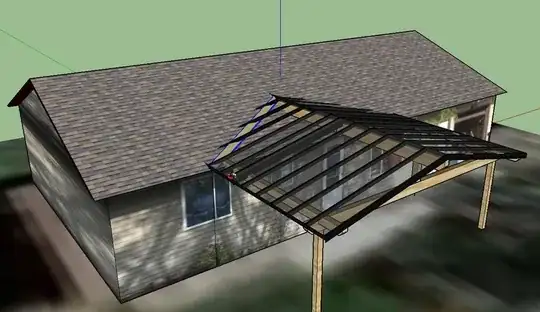

enter image description hereI am adding a covered deck and attaching to my house. I want to attach it like the project about which funtastic asked this forum May 20 '14 at 6:47 and was given a response to his question by shirlock homes a few hours later.
My question is: How are the beams that support the rafters supported at the house? I have seen house roof decking, soffit, and fascia removed to expose the top of the exterior wall. This seems dependent on needing proper studs in the wall to support the beams and in the above mentioned access method I have never seen the side wall opened to accommodate this.
If the beams are supported by support posts from the ground and then the roof tied in like funtastic's it appears that this may lead to deck roof movement independent of the house roof which it would seem to lead to shingle interlacing failure.
Sorry if I am too long winded but I have tried to think this through and be confident in the outcome. Thank you for your expertise

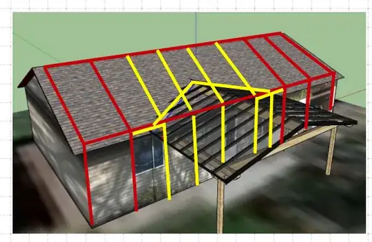

You have to tie the deck roof to the existing building framing. In the picture below, the red lines are the existing joists and studs; the yellow lines are either new additions (joists/studs/lintels in locations that do not have those supporting elements) or strengthening/modification of the existing structures.
Similar to:
Or,
r13
  • 3,422
The problem I see with what's you've sketched is that load of approximately 1/4 of the added roof is going to be carried by the existing roof rafters, unless you make some structural changes there. This may,or may not be acceptable.
You can avoid this if you use a scissor truss of some sort for the deck roof. With a truss like that, you do not need a ridge beam/board on the deck roof, and the load of the new roof is carried by the beams coming out from the house. Of course, they have to be sized appropriately.
