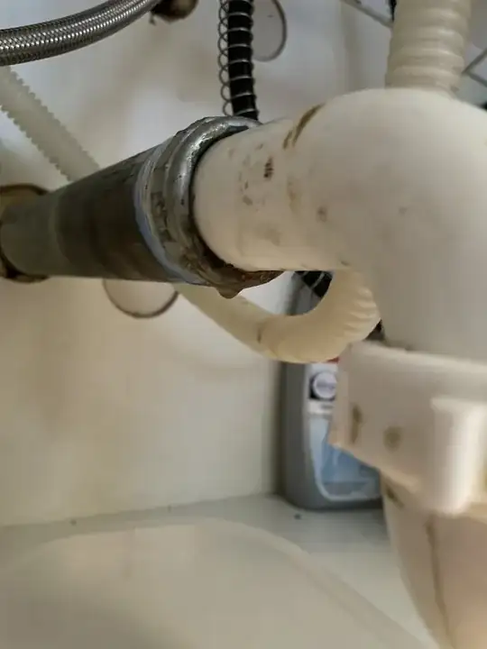

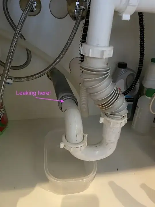

We have a somewhat interesting set up under our kitchen sink. There is a flexible pipe fitting connecting the sink drain to the waste pipe. We recently had a clog in the line and I had to disassemble that connection to unclog it. Now that it's unclogged and connected again it's has a small drip leak where the pvc connects to the waste pipe (see pics below).

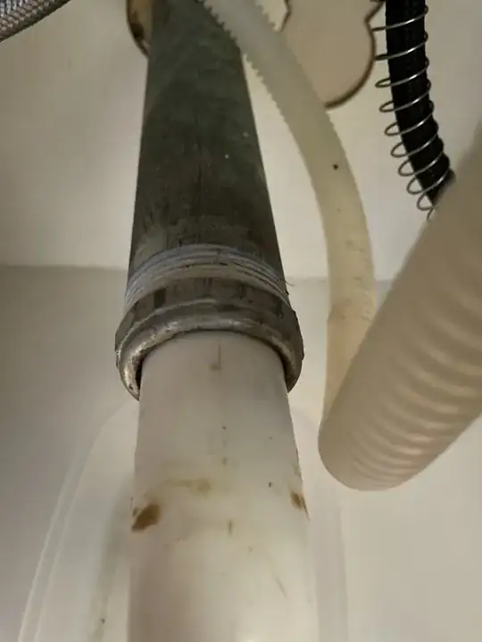

As you can see, the pvc pipe isn't really secured onto the waste pipe. It was kind of just shoved in there maybe 8 inches. It wasn't leaking before but now that I removed it and put it back it has a slow leak. The last person to disassemble this was a plumber so I'm not sure what theory was on how that connection is supposed to be secured. Did he put some kind of sealant on it maybe? It does feel greasy on the outside, maybe like silicone. Whatever it was, apparently it worked and removing it has done something.
So how do I stop the leak?

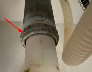

The metal stub from the wall should have a washer inside the sip joint nut (red arrow):
metal stub pipe from wall indicating where the slip joint nut is
Click to embiggen

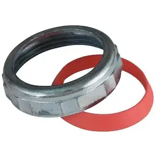

If your plastic pipe simply slipped in, then either the washer is completely missing or has stretched to the point where it's no longer functional. This is an example of a replacement slip-joint nut and washer:
Slip joint nut & washer
Image courtesy of lowes.com. Not endorsement implied or intended
This one happens to have a red rubber washer. Most of the ones I've used have been some sort of translucent white plastic. I'm not sure which is "better", but they both seem to work just fine. The sloped shoulder of the washer goes toward the pipe being attached to, while the square edge goes toward the nut and is tightened in place as the nut is tightened down.
