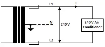

I am running wire for a 240 V, 20 A split-system AC over a hundred feet and the voltage drops below the allowed NEC 5% voltage drop.
So I have to step down the a wire a gauge and run a #10 wire which will allow me to send the correct voltage. Usually, when running a 20 amp wire, you don't need to run a neutral because the load is balanced.
My question is that as I'm running a 30 A wire and only using 20 A, do I need to run a neutral to send the unused 10 A back the supply?

There is no 'unused 10 A'.
However (and this is physics, not building codes) if because you now have 30 A phase wires and you put 30 A breakers on them, and there is any possibility of you connecting an unbalanced 120 V 30 A load at the end, then this will use the neutral wire at 30 A. Your breakers should not be larger than the smallest wire in the circuit.
If there is no neutral there, and you can only use a balanced 240 V supply, then there is no problem. Size the breakers for less or equal to the phase wire rating.

A 30A circuit does not push 30 amps. It pushes 230 volts, and the appliance draws however much it needs. As such, no need to return any extra amps... they just won't be taken.
The circuit breaker is a gatekeeper that prevents anything from drawing significantly more than 30 amps (or whatever).

There is never a need to "send back the current in excess": things are different.
Even more if you talk about cables size: the difference between cables of different size is that the thicker cables have smaller resistance, so they heat less, so they dissipate less energy and the voltage drop is reduced.
It comes to my mind some other person asking "my xxxx runs at 12 volts, but the original power supplier is broken. It was 12V 3A. I've found a replacement, but it is 12V 5A. Can that more current harm?". Well, the reply is no: the xxxx device cares about the voltage and "at least" the current it needs. If the power supply can give more current, that is not a problem: it can, but it will not be asked to supply more than those 3A the xxxx asks.
Your situation is the same: your HVAC will consume no more than 20A and, even if the supply and/or the cables can carry more, those 20A will remain 20.

My question is now that I'm running a 30 amp wire and only using 20 amps, do I need to run a neutral to send the unused 10 amps back the supply?
There is no need to run the neutral.
Only the rated current of the AC Unit will be drawn from the source.
There is no question of the source feeding more and taking back the excess.
