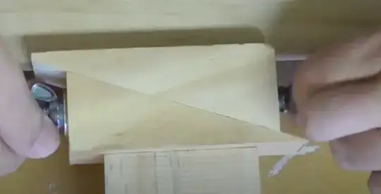

Power Wedge with Wing Nut
Build a power wedge from some wooden wedges, a bolt and a wing nut.
It will be strong, simple to tighten, and seismically safe when the bottom wedge is fastened to the top of the cabinet.
Tightening the nut will pull the wedges together, and you have leverage (e.g. 3:1) from the angle of the wedge.
Drill the through hole before cutting the wedge diagonal, and choose a hole diameter that is perhaps 2x the diameter of the bolt shaft to accommodate angling of the bolt. Simply cover the oversized hole with large enough washer on both ends.
Power Wedge with Power Tool
You could also replace the wing nut with a T-nut and drive the bolt with a power tool and a hex bit.
https://www.youtube.com/watch?v=nq8RM-E4THk

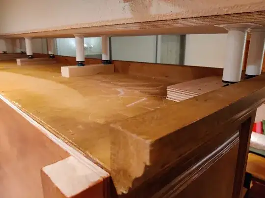

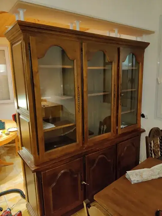

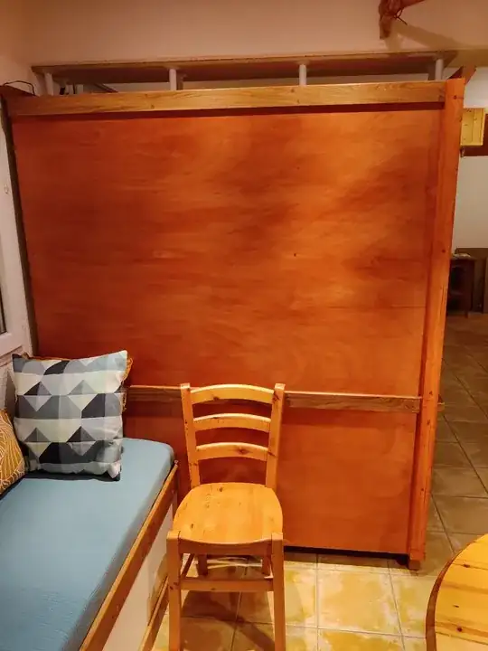

Here is what I did in the end
Another idea that occurred to me: adjustable feet, placing them at the top of the furniture rather than the bottom. Found some at the hardware store.
Thanks for everyone's contributions, I learned heaps of ideas for next time.
Shelf stabilizers Front of stabilized shelf Back of stabilized shelf
