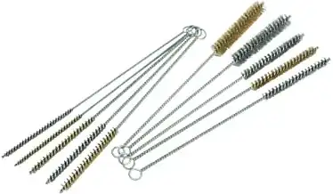

Any good decalcifying agent will work - CLR, Kaboom,to name two, or even vinegar. The hard part is getting it up into those holes under the rim. I suggest you get yourself a set of small round wire brushes, dip them in a decalcifying cleaner and ream out the holes.
