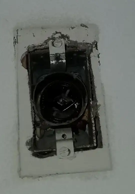

In our 1959 ranch-style home there is an outlet on a living room wall more than halfway up. Anyone know for what use this may have been installed? It looks built-in when the house was built.enter image description here

Probably for a plug-in electric clock.
I would bet it is for a what was called a "pin up" lamp. A wall lamp with a short cord that was considered stylish and ornamental then. Sometimes placed in pairs, one slightly higher than the other.
Is it near the front door? It may have been for powering a doorbell.
Is it located near a telephone? Could have powered an external ringer/clapper unit to alert on incoming phone calls.
But what can it be used for now? Sounds like an excellent position to put a wireless repeater or access point, or even a low power LED left on all the time as a night light.
