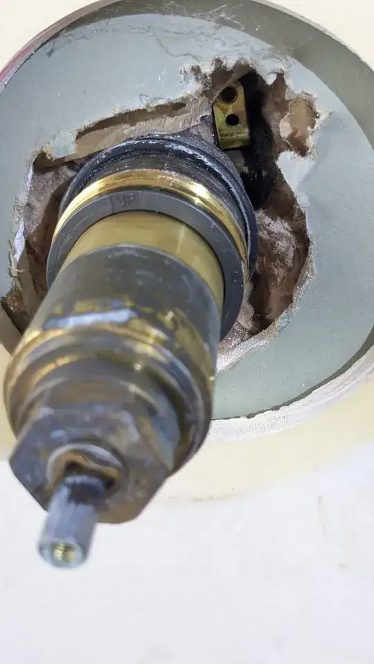

From what I can tell I have this Delta universal rough in.
Am I correct that I have a mismatch?

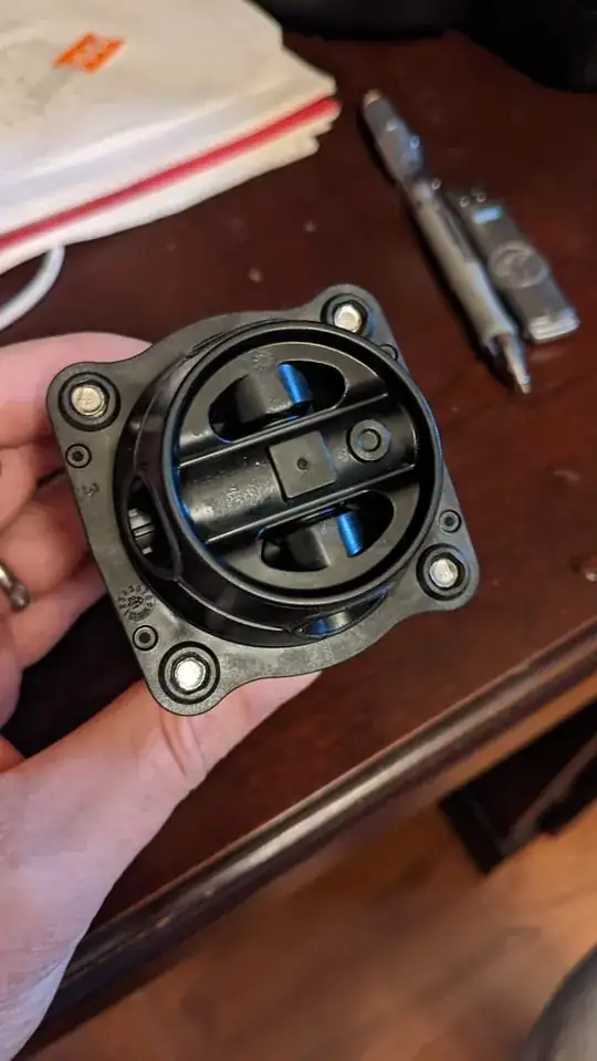

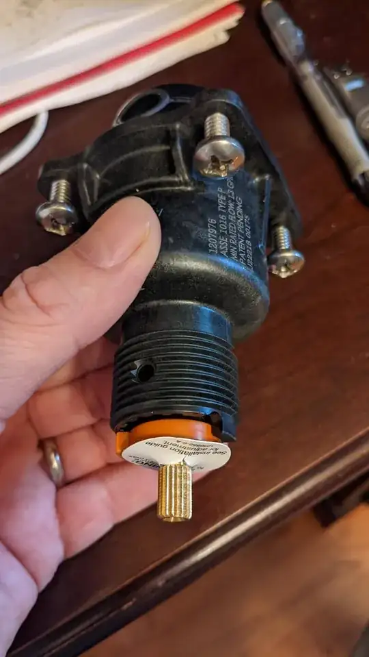

This is the new Kohler cartridge

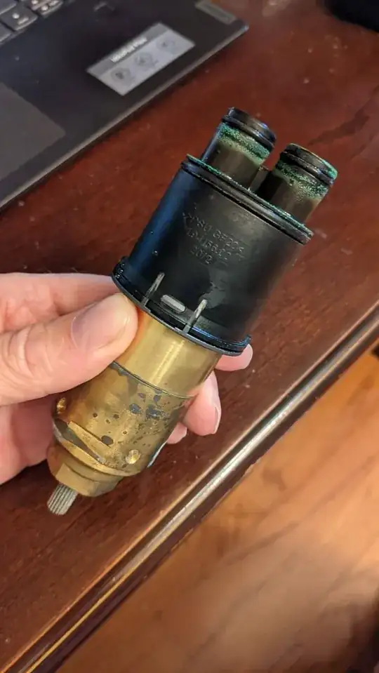

And this is the existing Delta cartridge (still trying to get it out). enter image description here
EDIT
Okay, I got it out, and they definitely do not match. enter image description here So does Kohler make a valve that'll fit this "rough in"?

That Kohler cartridge will not fit into your Delta valve. You will need to get a Delta replacement cartridge or replace the valve with the right Kohler valve. Yes, you do have a mismatch. You need to get the old cartridge out first and then go from there to get a replacement.
