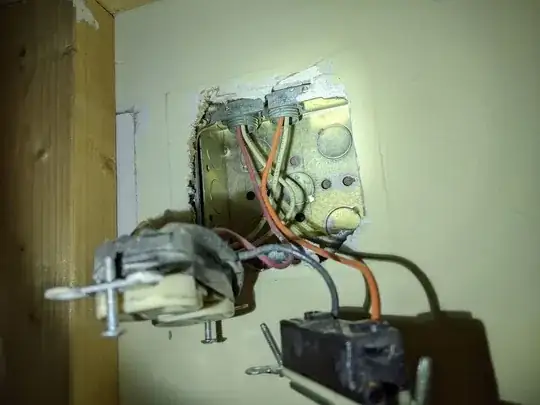

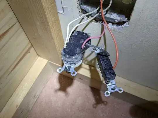

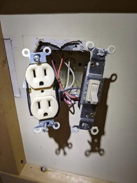

I have a box with a double receptacle and a switch where the switch powers an exterior outlet on the other side of the wall. In the photos below, the orange is the switched hot for that outlet. All receptacles I've tested in my house so far are grounded to the box, this one included. I was hoping to replace the switch here with a smart switch, for which I'd need to procure a new neutral connection. My question is, can I split the neutral wire coming into the box and pigtail it to the smart switch?

Yes, that's the correct neutral.
Hot goes to inside receptacle and then to switch. Which means the receptacle controlled by the switch, and any smart switch itself, must use the same neutral as the inside receptacle. There are currently two neutrals connected to the receptacle, one to the switched lights and the other back to the breaker.
Remove the two white wires. Add a short white to the receptacle and another for the smart switch and connect them together with a wire nut.
Outdoor receptacles should be GFCI protected. For a bunch of reasons, including the addition of a smart switch, that is best done at the breaker panel or another location before the switch. If you currently have an outside GFCI/receptacle you may want to put that inside in place of the inside receptacle and install a plain weather resistant receptacle outside. But if you do that then instead of combining all neutrals you will need to properly separate LINE and LOAD.
  • 139,495
  • 149
  • 386
The two existing neutrals are electrically connected inside the receptacle. Presumably one of the two continues to another outlet. You can verify this by removing the black insulation tape and checking that the bridge of the receptacle on the neutral (white) side is still in tact.
If this is indeed how it's wired (likely), then yes, wire the two existing neutrals together, add a pigtail neutral to go to the receptacle, and tie in the neutral from the smart switch. For reliability it is best to connect the pigtail to a screw terminal rather than a backstab, but they are electrically the same. Same for the lives.
