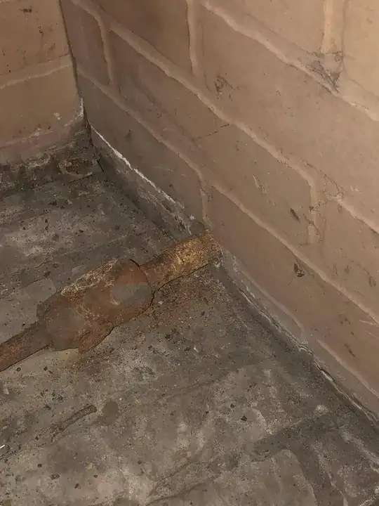

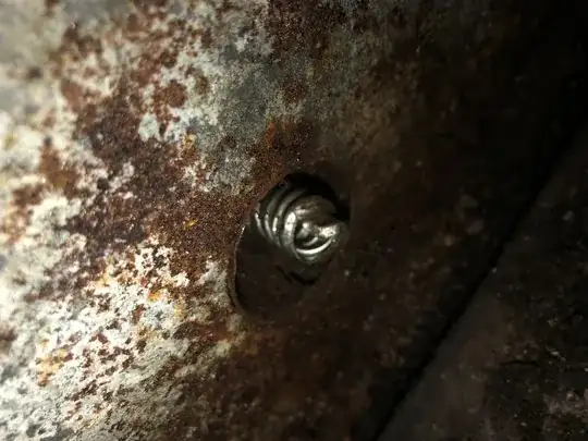

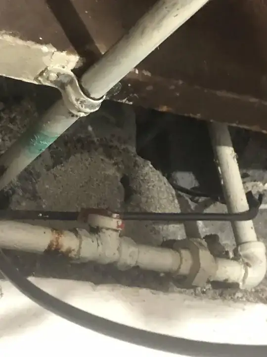

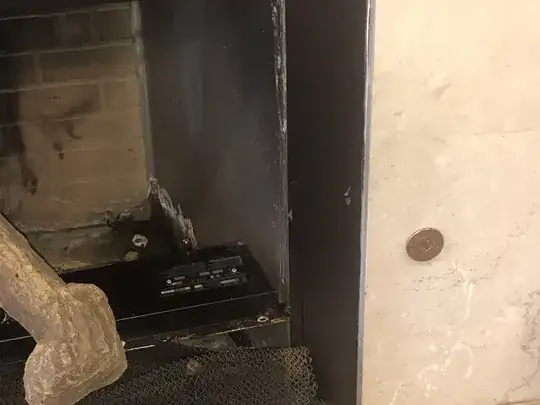

I’m trying to install a new gas burner on an old gas fireplace. There is a rigid gas line that comes up from the basement. From that point it is hidden behind a wall, until there is a valve key/escutcheon. There is a ball valve on the rigid line in the basement which is closed. I've tested both that valve and the valve key - no gas currently flows unless both are open, so seems like we are safe there. At some point behind the wall the rigid line must be connected to a flexible appliance connector. There was an old, very rusted burner attached at the end, and when I tried to get it out I accidentally broke off the end of the flex connector. I can only reach about an inch of the end of the ripped line, the rest is behind the fireplace and wall, inaccessible.
Is there any way to safely connect a fitting or anything else to the line?
Rigid line from the basement with closed valve: enter image description here
Valve key and fireplace with stub of the connector visible: enter image description here
Gas line stub:
Old burner: this was previously attached to the connector, I've since removed it as well as the fake brick wall to give more access to the gas line:
Huh, how did you shut off the gas before breaking it then?
Something is accessible so you should start with that something and run a new line. The existing line doesn't have enough accessible length for you to add a joint properly.

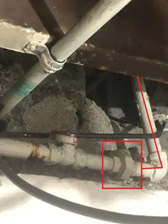

Based on your edit you need to disconnect this union and run new pipe. This of course assumes that the right side leads up to your fireplace.

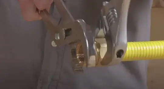

CSST terminations typically require that you wrench on the last inch or two of tubing, much like a compression fitting for plumbing. You'd need to gain a little slack there to accomplish a safe connection.
https://www.youtube.com/watch?v=oHqgFm9Li2s
