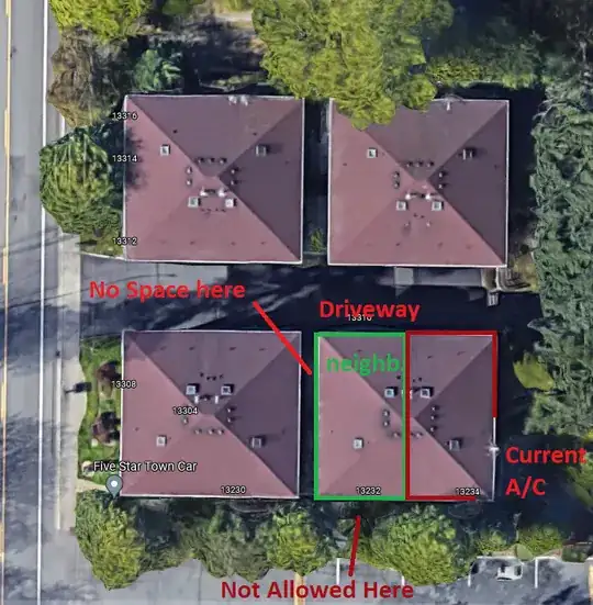

I live in a 2-unit town home. I have installed an AC on the side of my unit. My neighbor would like to install an AC for their unit. However the city codes will not allow them to install it on the side of their house since it is too close to the property boundary. The front and back of their unit is also prohibited by other codes.
One solution is to allow them to install their AC on my side of the house (shared property) and run the refrigerant lines thru my garage. Are there any problems I should be aware of for this kind of arrangement? Are there any alternatives that folks can think of that doesn't involve going thru my garage?
diagram showing layout of buildings top-down view of the properties

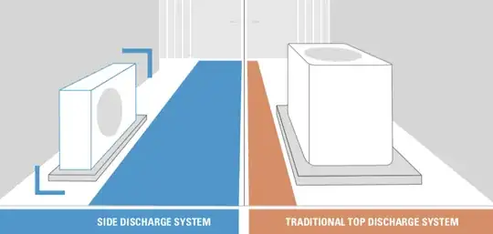

Don't run the lines across or through your property. Your neighbour should consider something more compact like a side-discharge A/C unit. These are available for both mini-split and central A/C units and would certainly fit on your neighbour's side.
Side-discharge units can even be mounted directly to the side of the building and won't even extend past the eaves, so there should be no issue with it being too close to the property line. This is also much less of an eyesore than anything roof mounted.

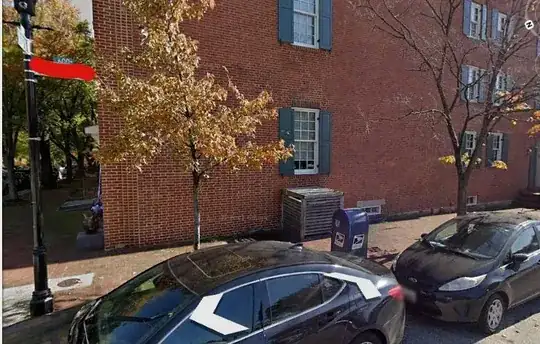

Not an answer, but this is the only way I could post a picture of a friend's house in the city, with the AC unit sitting on the sidewalk next to the house right behind the mail box. Yes, he had to go to the city to get a waiver to do that.
OP - Has your neighbor applied for a variance? That should be the first approach. Like others have said, almost all jurisdictions have a process whereby bulk requirements (like building setbacks) can be waived.
