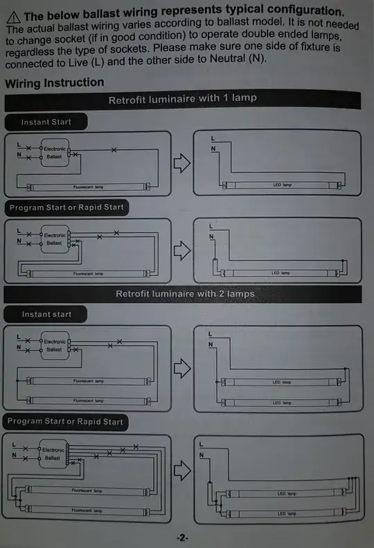

I have had no problem retrofitting my 4-tube fixture. However, my 2-tube fixture is confusing me. The way that it should be wired up is according to this diagram:

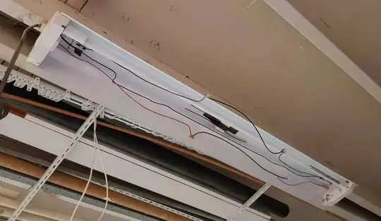

I cannot find the ballast for my 2-tube fixture. I removed the cover in the center, and the wiring that was exposed looks like this:

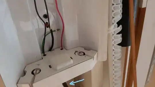

As you might be able to tell from the image above, there are only a few wires in the fixture. Here is one end of the fixture. The blue arrow points to the cord that goes to the wall socket. There is a green wire (which I presume is ground wire), 2 black wires, and a red wire.
So I was trying to find the ballast, and I thought maybe it might be the small white box in the middle, but I have never seen one so small and light. There are no markings on it either, so I could not search up any model numbers online. The white box is connected to one red wire and one black wire.

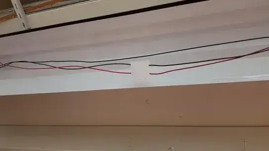

I tried eliminating the white box and connecting the two sides of the red wire together, and the same for the black, but it doesn't work. Same goes for trying to connect red to black, black to red.
I'm pretty confused at this point. Normally black and red indicate live wires, but seeing as there are no white or yellow wires, I'm guessing one of them has to be the neutral, but I don't know which one. I don't know what the white box does, and I don't know where the ballast is.

It's not going to work with these.
I do a lot of fluorescent conversions - mostly from T12 to T8 since I like real fluorescent.
I recognize those particular fixtures, with the molded-in tombstones and lumps on the ends. These are the "Uber-cheap" variety. They were made as chintzy as possible, and that includes not having a normal ballast. What little ballast they have is actually in the "end plates" on both ends, hence the funny lumps.
You could try hacking open the end casings to get inside them. However, when I tried, I found that I had to do so much damage to get into them that the unit didn't re-assemble properly. I just scrap these when I get them.
