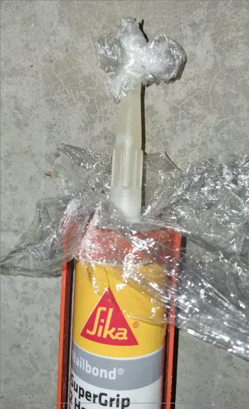

For long term storage (more than 1 or 2 days), I remove the nozzle, put some plastic wrap/cling film across the opening and put the nozzle back on. I've been able to keep partially-used tubes for almost a year with this method. You either clean out the nozzle or put a new one on when you are ready to use it.
For just 1 or 2 days, I just wrap the plastic around the tip so I don't have to clean out the nozzle, but more than a few days and enough air still gets in to cure the product.
Here's an example, just used this tube 3 days ago and opened it originally in July 2021. Was as good as when I first opened it.
Plastic around tip for 1 to 2 days, plastic between tip and base for long-term storage

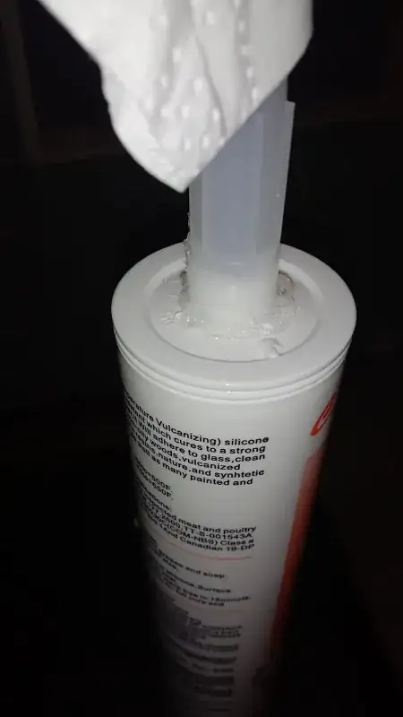

Caulk the base of the nozzle to create a perfect seal
(Do this before using it so you do not expose the unused silicone.)
I've had this stuff store for more than 2 years using this technique.
I tend to do this before loading the tube into the gun but you can do it after just the same. You don't need a lot and you can push out a little caulk with pressure from your fingers after cutting open the tube. You apply a slight amount all around the base of the nozzle and the twisting motion will spread it evenly to seal it.
If stored for less than 6 months, you may be able to just grab the hardened stuff and pull it right out in one piece. I've had mixed success, but sometimes it breaks and you'll have to push it out.
After 6 months of storage, the caulk in the nozzle will harden about half way down and you'll need to take it off and push the hardened stuff out (or you cut a much larger hole in the nozzle), but otherwise the rest of the tube is brand new.
This has the major advantage of not causing caulk to cure inside the tube because there is zero exposure. When you're done, wipe off the excess and store.

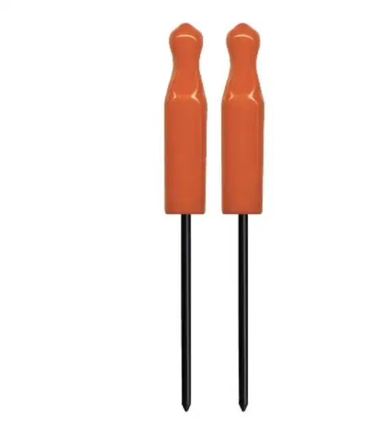

There exist many kinds of relatively inexpensive reusable caps -- I prefer the ones like these:
caulking tube caps
Image source.
The pins ensure that the nozzle isn't blocked by the solidified caulk.

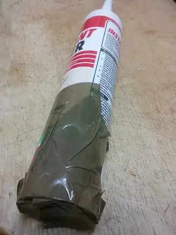

Dandavis above rightly noted that you also need to block drying via the back slider bung. Sniff the back of a started cartridge, it smells of vinegar. That is the acetic acid solvent escaping from that end (liquid silicone and an open nozzle will smell the same).
As an alternative to tightly bagging a cartridge, you can make an airtight seal across the rear of the cartridge with a few strips of parcel tape. Well worth having to strip this off next time you use it.
