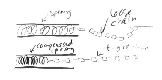

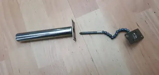

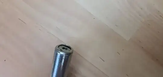

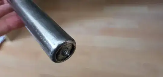

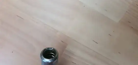

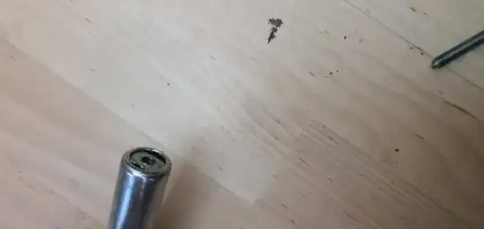

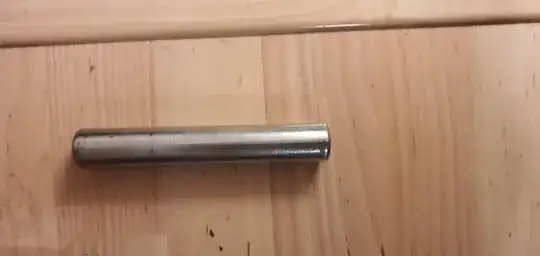

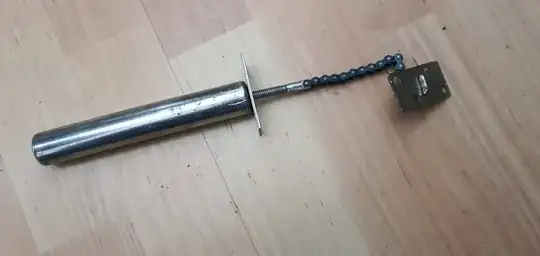

There is a cylinder with a spring inside. Presumably when the spring is compressed it will pull the external chain attached to it to be taught, I.e. not slack.

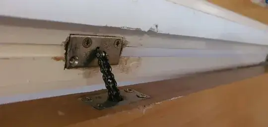

But I can't keep the spring compressed to then insert it back into the door cavity and faceplate on top.
Here's a sketch of what I mean by the spring inside the cylinder.

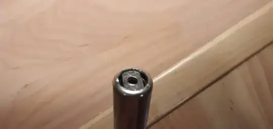

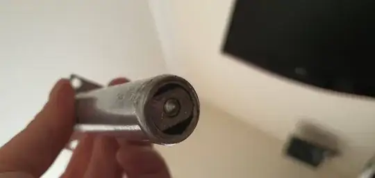

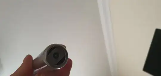

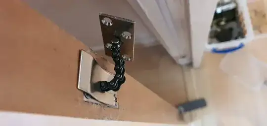

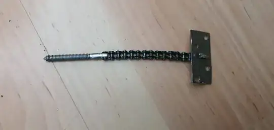

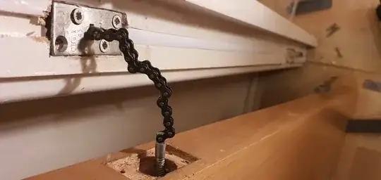

Looks like I need to twist the chain to increase the tension, according to this Q&A: How to stop self closing doors from slamming
Thanks to jsotola for their input.
There is another faceplate, which I had while working on this, but not shown in photograph. But, as jsotola suggests, I should check for other missing parts.
Key things:
  • I was putting it in the wrong way around.
  • Need to use a chain stopper, clip to hold chain while fitting.
This video was key to my understanding too: https://youtu.be/P5SalSwsigc
