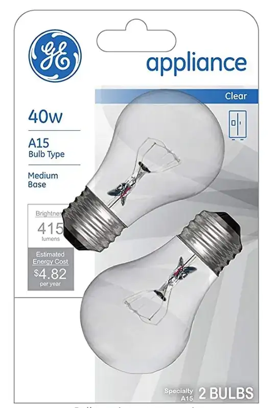

No, any 40W incandescent that is similar size and base will work just fine. I would buy these ones from Amazon. Replacement and a spare for $5.
If you have one locally, go to a dollar store (like Dollar Tree, 99 Cents Only Store, etc.) and get an Appliance Bulb.
I bought one at Dollar Tree recently. Cost $1 or so.

I do a lot of baking in my gas oven and, in my experience, generic "appliance" bulbs do not last. The original bulbs in my oven lasted years. Generic appliance bulbs I've purchased last maybe 1-2 months. That said, I agree that $20 is way overpriced. But I can tell you that bulbs priced less than $5 (US) are likely to be generic and are sold to work with fridges, ceiling fans, range hoods, etc. and they will not last in an oven if you bake often. I believe you need a specialty bulb for an oven. I came upon this thread because I'm looking for a good one. I'm going to try a $10 Phillips bulb next.
