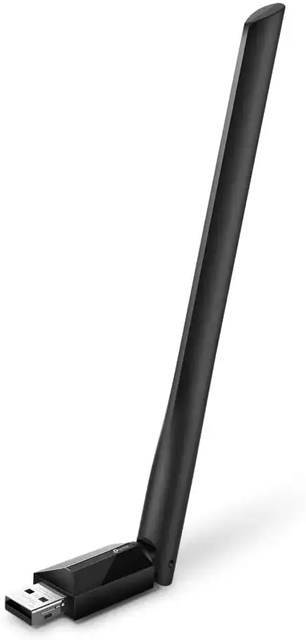

  • USB WiFi adapter for the computer - If the computer has a USB port, you can get a USB WiFi adapter like this:
USB WiFi
Some of them are really small - the same size as mouse/keyboard wireless adapters - but I find the ones with big antennas tend to work better. I have used these to add WiFi to computers that didn't have WiFi, to replace broken internal WiFi adapters and to improve WiFi performance (e.g., go from 2.4 Ghz to 5 Ghz).

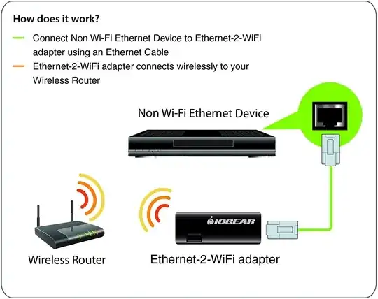

  • Wired ethernet to WiFi adapter - This lets you take any ethernet network wired device - not just a computer (which could just as easily use a USB adapter) but a printer or other device - and connect it to a WiFi network. You program it (methods will vary) to access the WiFi network and then connect it to your non-WiFi device. This is one example:
Wired to WiFi network adapter
I have not used this particular adapter, but I have used similar devices in the past.
