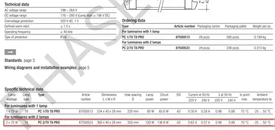

Tridonic 87500523 product image Tridonic 87500523 manufacturer spec
The replacement ballast has 6 wires whereas the original had 7 wires (pin 7). From the wiring diagram, it appeared to be surples to requirements, so I removed it.

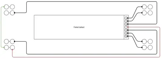

Each bulb "socket" has four electrical connection points (depicted by the circles). The original was wired thus: enter image description here

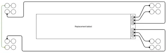

I rewired it, removing the wire shown in red: enter image description here
The light powers on, but only stays illuminated for about 5 minutes. I can wait 3-5 seconds, flick the light switch and it illuminates again, but then turns itself off after about another 5 minutes. The pattern continues.

I presume that your double circles mean that each pin of the lamp-holder socket is connected to 2 terminals. (so 4 terminals per lamp holder). That's exactly how it's done in North America also.
Your diagram showing the wiring changes is exactly correct. Assuming the greenish wire on the far left didn't get jarred or messed up in an unexpected way.
