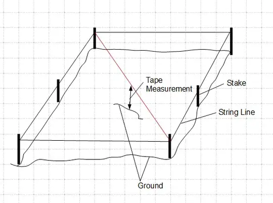

Set stakes around the proposed site for the shed, attach string lines/wires, and make sure they are level. Then measure the distance between the string line and the ground periodically, and make sure the distances measured remain the same. Done.

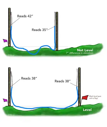

You can make a water level from a couple of yard/meter sticks and a length of clear vinyl tubing. The difference in height between any two points is the difference in the water level on the measuring sticks. These require two people to use, but they can be as long as you need.
Image from Permaculture News, attributed by that site to Lake of the Ozarks Permaculture, but that link is broken for me:
If you're moving earth around, be sure to thoroughly tamp the areas you fill in to ensure they won't settle further.
