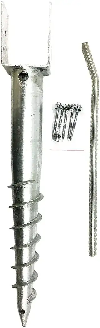

Ground screw.
source
Screw this down through the old wood post. The depicted ground screw is 27 inches but I am sure you can find others if that is too long. The screw will be anchored in the old wood all the way down and through into the concrete. The top of the ground screw will hold your new post.

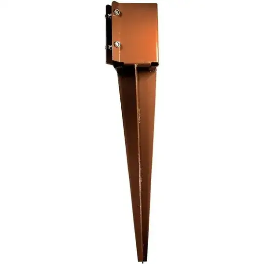

If it broke off below grade, you can fill in the original hole and use a drive-in stake anchor for a new post in a new spot.
As long as you have the ability to move left or right a foot or so, this should be viable. Note that you’ll still need to call to have buried utilities marked before driving in the new anchor.
mailbox post anch

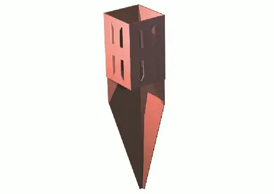

You can get a steel 'repair spur' that is designed to be driven into and around the broken post. They are shorter than normal steel post spikes
repair spur

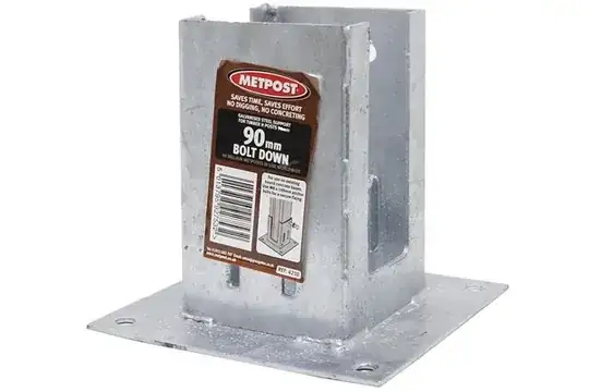

Alternately, you could fit a bolt down anchor over the hole (possibly filling the rest of the hole with concrete first)
bolt down anchor
