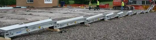

Depending on where you live, you might be able to rent a conveyor. This is a Miniveyor, available in the UK.
Miniveyor mini conveyor belt
I considered this for a similar job in my back yard, but I only had about 12 cubic yards of debris. I removed a fence panel and brought in an excavator
