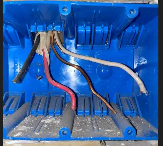

I opened the box where the previous outlet was and found 10/3 wire w/ground (picture below), even though the dryer outlet on the other side of the wall and the one we had removed are both 10-30 receptacles, and so ungrounded (home was built in '92). Testing these wires confirmed two hots at 120V each, one neutral and a dead ground. Odd thing is, the bare copper wire which should be the ground wire is wired as neutral, and the white neutral wire is dead. A no-contact voltage tester indicates the bare copper has live but low voltage present. With a DMM, I get 120V from either hot to this wire, and nothing from either hot to what I thought should be the neutral. Is this normal, or am I doing it wrong?
Yes, that's just the kind of horky nonsense we see anytime NEMA 10 is involved. In fact it's a bit of a surprise to find a groundless NEMA 10 in 1992, since groundless #10 wires were all but gone from the market. Some people installed 10/2 w/ground, and abused the ground as neutral; but that has always been forbidden (and thus, NOT grandfathered). Once old stocks of 10/3 "without ground" ran out, you were to use 10/3 with ground and simply not connect the ground if using a NEMA 10-30.

First of all, if that dryer outlet was for a 220v only dryer, that configuration would be correct. They probably just only had that wire type available. You only need the neutral connected if there is a 120v requirement as part of your device. Otherwise 220v plus ground is all that outlet needed. And it would be absolutely correct to read 120v between each leg and ground. Remember that your neutral wire is grounded at your main panel in standard configuration, so with no current flowing they will measure about the same.
