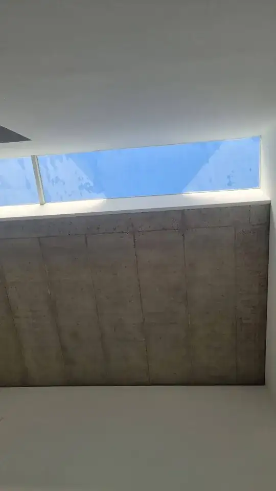

We have a fixed skylight in the point of the house where we have stairs and this continues to an office that we have. Therefore the office is in an open space with the stairs and the skylight. This is around 6 meters x 70 cm and is fixed. We have never had leaking issues because the window is fixed.
We have had the house for 8 years, and every winter we have the issue that on really cold nights, condensation forms on the skylight and all night we hear drops of water from the skylight. This is probably because we unfortunately made the error of putting single glazing, and not double glazing, on the skylight.
I applied a window a film and also sprayed it outside with a matte transparent paint but this just reduced the August sun, and there is no change in the winter.
Also the other problem that we have is that sitting in the office feels very cold in winter, because of all this open space. I assume that if the glass is so cold it could also make a difference in temperature, correct? Or is the cold feeling because of the double ceiling height?
Therefore, we are thinking of closing the skylight with gypsum board. We want to stop the condensation issue in winter, and also possibly stop this really cold temperature that we think is caused by the cold glass.
Would you say that is OK to close this with gypsum board, or will the condensation continue and lead to mold over time? Would it help to put insulation between the glass and gypsum board?
picture of skylight window with condensation

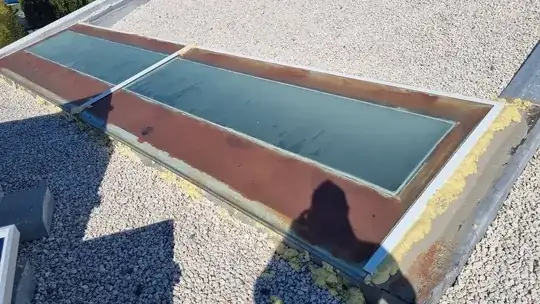

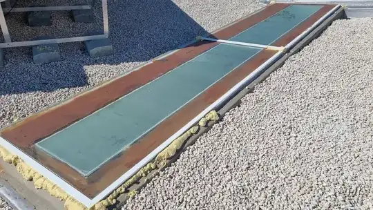

Attached are photos from the roof, as an FYI guys. This is a custom made window. The roof at that point is sloping, and the brown color was just a paint i did thinking that would make some difference... enter image description here enter image description here

If you simply cover the bottom of the opening with drywall/plasterboard/gypsum board, you'll still have condensation on the skylight, though possibly a little less because the drywall will slightly insulate the window opening. The difference is that instead of dripping onto the office floor/down the stairs, it'll get collected on top of the drywall. Instead of irritating you each night, now you won't notice until the drywall gets so soggy that it collapses onto your desk chair.
Insulating the cavity between the drywall and glass will help, but it's very much a short-cut way of doing things. It will likely have a negative impact on resale opportunity/value when it comes time for you to move on. People will look a the lovely skylight when they're looking at the outside of the house and wonder where it went when they're looking at the inside. They may wonder what other short-cuts/shoddy workmanship was done and it could scare them off from making a purchase.
If you really don't want the skylight any more, the proper thing to do is have it removed and have the roof patched in with plywood & shingled over to match the rest of the roof (or sealed and graveled, now that we have a pic of the actual roof in question), then insulate the cavity in the rafters, then drywall and finish the interior ceiling.
If you like the light but want better insulation, replace the skylight with one with double- or even triple-pane glazing, possibly Argon filled (for better insulation) and low-e coatings to help keep the UV out and the heat in.
A replacement skylight (whether just the glazing or a whole new unit) won't be cheap, but will probably be on par with filling in the hole with solid roofing material. Either will be less expensive than a hospital visit if you happen to be sitting in the office chair when the drywall gives way because of the condensation that's collected on it.
