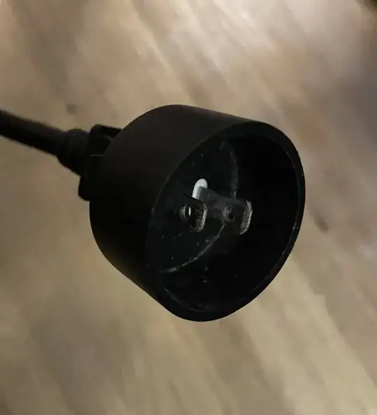

What is the purpose of putting a flange on a plug like this (from yard equipment)? Help me understand.
a flanged plug
It’s not like it’s waterproof.
It seems to me it only serves to keep you from plugging it into a cord with a built in splitter. And even with a single outlet cord, they don’t hold well.
The solutions I’ve seen are:
  1. Breaking off the flange
  2. Using a pigtail extension (e.g., 1 foot single outlet)
  3. Replacing the plug with one without a flange.
Any better options? What am I missing?

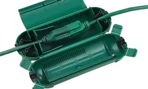

Should you require electrical protection of the prongs, due to water/grass/snow, or if the plug and receptacle keep slipping off, you could use an "extension cord safety cover"
