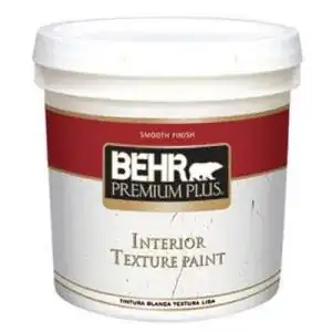

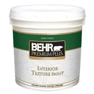

I just recently learned that some wall/ceiling textures can be applied with a paint-roller and special texture "paint".
Here are a couple examples from Home Depot:
alt text alt text
I was hoping to get more information on this technique. I'd specifically like to know:
  • What types of texture patterns are available using this method? Some types look like they could be done by either rolled-on or spray (e.g. Perlite).
  • How do the finished results compare to other texturing methods? Is there a noticeable difference in quality?
  • Is there a cost benefit for rolled-on textures?
  • Is a rolled-on texture easier for beginners to apply?
-M

Rolled on texture is easy for anyone who can paint. However, do not get that pre-mixed stuff. It's nearly impossible to get it to a good consistency. Go with the texture additive that you mix in yourself. Just wear some old clothes because tiny bits of the texture are going to shoot off the roller and get on you (more so for a ceiling job).
All you need to do is pay attention to the texture coverage. Rolling vertical and coming back over on a horizontal to get uniform coverage. I'll do the texture in the first coat then do another coat without the texture to cover up any unpainted texture bits that are barely stuck to the wall.
