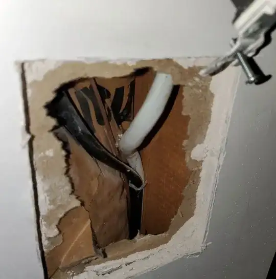

TLDR: The white wire is showing a current despite not being connected to power. Is that normal, and should I be concerned?
Long Version: In the picture is a white 14/3 wire running parallel and very close to a black 14/2 wire. They travel closely for about 8 feet to the crawl space below.
The white one used to be jumped off of the black wire in the box above this picture (but out of frame), but It is now wired only to a 3-way switch in that box. In the crawl space it is dead-ended in a junction box.
I was going to use it to operate a different light that hadn't been on a 3-way switch before by reconnecting it at that crawl-space junction box.
However, it is showing a current despite no known connection to a circuit. Is it possible that running so close to the live black wire makes it look like it has a current? And is it safe to use it as is, or should I crack into the wall more to separate them?

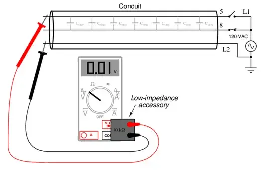

You can also buy a "Stray Voltage Adapter" for your digital multi-meter.
This adapter is basically a safe way to load the circuit and confirm whether the voltage is supplied by a source might possibly hazardous amounts of voltage (e.g. a through a resistive short or strong coupling) or whether it's supplied by a weak source (e.g. short run of parallel wires)
Stray or ghost voltages occur from capacitive coupling between energized circuits and non en- ergized, non connected adjacent wiring. Because of this coupling effect and the multimeter’s high impedance, it’s not always pos- sible to determine if the circuit under test is energized or de-energized, and this creates confusion for the person performing the test.

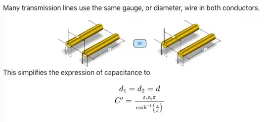

This is a DIY site, not an electronics site, but for those who'd like a backgrounder on capacitive coupling between wires there's this:
And

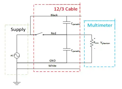

Here's a schematic of the capacitive voltage divider, thanks to an earlier post by Pigrew in 2013:
It's that voltage divider, formed by capacitors, which brings the voltage to the 40V to 60V range, from 120V, depending on the co-bundled number of neutral and ground wires.
The specific count of wires affects the voltage divider ratio. The length of the parallel/adjacent run determines the "strength" of the voltage, i.e. whether it merely triggers a voltage detector or reading on a digital multi-meter, or whether it is a hazard to someone working on the exposed wire.
