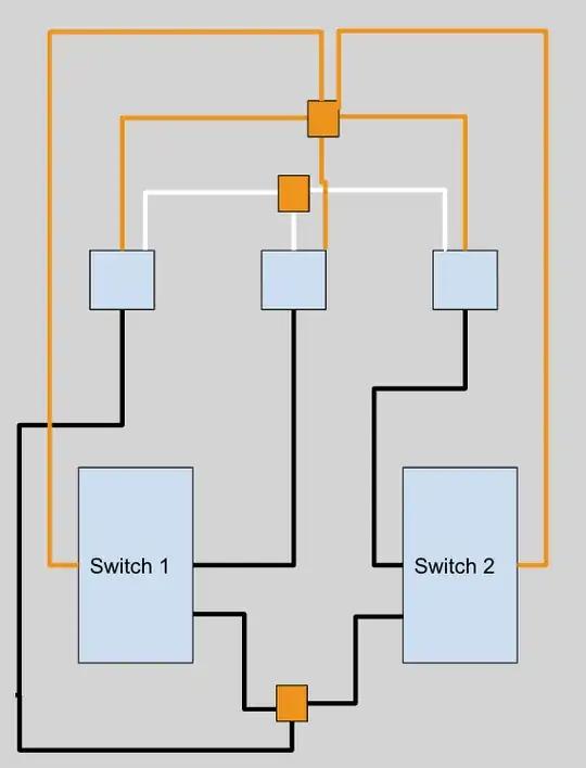

I have two light switches that I am planning on replacing with smart switches.
As the diagram below shows, there are three "collections" of wires coming out of the wall, where each "collection" consists of one black wire, one ground wire and one neutral wire.
The neutral wires are currently not connected to the light switches, and all just feed into one wire nut.
Two of the black wires connect directly to a switch, and the third black wire connects to both switches via a wire nut.
The three ground wires get grouped together, and two of them go to a switch, and one doesn't appear to be used.
Questions
  1. Why are there only three black wires, and not four? I'd expect each switch to have two black wires, one load and one line.
  2. Why are there three ground wires if there are only two switches? Surely Only two ground wires are needed?
  3. Why are there only three neutral wires, and not four? I'd expect each switch to have two neutral wires, as this was the case when I wired up a single smart switch elsewhere in the house.
  4. When replacing the existing light switches with smart switches, I assume I should keep the ground and black wires as they currently are, but what should I do with the neutral wires, that my smart switch will require? Should I just put all 5 (3 existing ones, plus 2 short wires connected to the switches themselves) neutral wires in one wire nut, or should I do something different?
Thanks in advance!
Wiring diagram

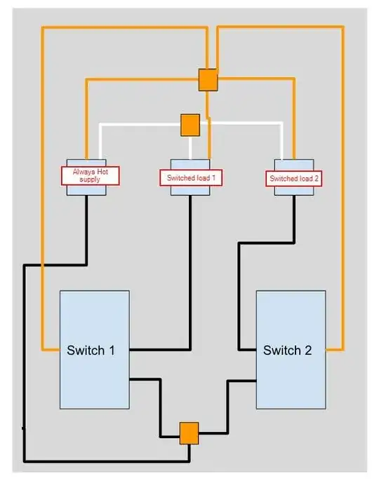

Note the updated diagram at the bottom with some additional labeling.
You do have 4 black wires. Switch 1 and 2 each have a line and load.
  • The line comes in from the orange wire nut at the bottom of the drawing and connects the "Always Hot Supply" to each switch. (The bottom black lines in your drawings)
  • The load goes out from the switches to the appropriate cable leading to "Switched Load 1" and "Switched Load 2". (The top black lines in your drawing)
There is, in fact, only one ground. It's provided by the "Always Hot Supply" and is extended by the wire nuts to the two switches and to the two switched loads. This ground needs to be connected to all devices in the circuit in case any of them experience a short of any kind.
Neutral doesn't need to be switched at all, that's why it doesn't go to the switches. There are cases where neutral needs to be switched, but that's generally limited to multiple power sources (if you have solar panels or a generator providing power to the panel) or in industrial/commercial settings.
Your new smart switches need to have neutral supplied to them because they are actually drawing a load on your power supply in order to power their internal "smarts". Your existing "dumb" switches simply open or close the circuit, and doing that on the hot side is more than enough.
IF the wire nut is big enough to handle three 14/2 (assumed) or 12/2 (possible) wires and the addition of the two smaller stranded wires coming from the smart switches, then yes, you can simply add the smart switch neutrals to the existing wire nut. If the wire nut on the neutral wires is the same size as the one on the ground (with 5 wires), then it should safely accept the two additional smaller neutrals from the switches.
If the wire nut on the neutral wire is smaller than the one on the ground wires, it likely is not big enough to handle any additional wires and you'll need another pig-tail and another wire nut to be able to break the wiring out to ensure that you've got a solid and safe connection for those 5 wires.
updated version of original diagram with additional labeling of the cables

There is one unswitched hot power feed which goes to both switches, This has one incoming neutral, and one incoming ground.
There are two switched hots leaving the box, each has an outgoing neutral and ground.
Yes, the smart switch neutral wires go with the rest of the neutral wires.
The unswitched hot of the smart switches goes to the one shared black wire. The switched hot of each one goes to the single black wires.
