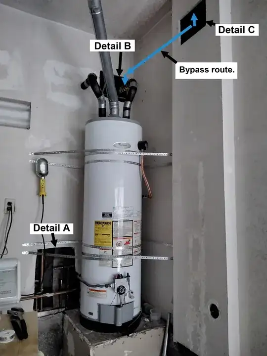

I finally found the water leak in my condo. I cut and cap a 1/2in pipe and the hissing sound of water went away. Now I have to figure out how to install a bypass because I lost the cold water in both the bathrooms sink. I still have hot so no hurry to fix. My neighbor has a leak too and a plumber is coming tomorrow for an estimate. I'll ask how much to install my bypass but for now I'm assuming I have to do it. I cut the dry wall and took pictures.
The bypass: I want to go from the water heater inlet to the right as shows in the picture with the water heater.The details are as follow:

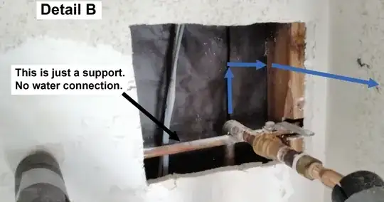

Detail B: I'll remove the right angle that connects the pipe with the gate valve and install a "T". This is all 3/4" pipe. The valve and pipes goes back to the original position. The top of the "T" will have a reducer (3/4" to 1/2"), street elbow, etc. to extend the pipe towards "detail c".

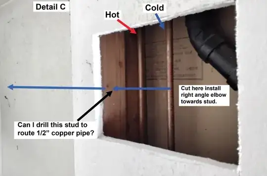

Detail C: Cut the cold water line (this goes to the bathrooms sinks). Install a couple of elbows (need to stay away from hot pipe). Drill a hole through the stud (is this OK?) and extend the pipe to join the one from detail B. This pipe is not really long (~2 ft) so it will be a single piece. I'll have to make sure all the fittings are fluxed and ready before I start to solder. Done.

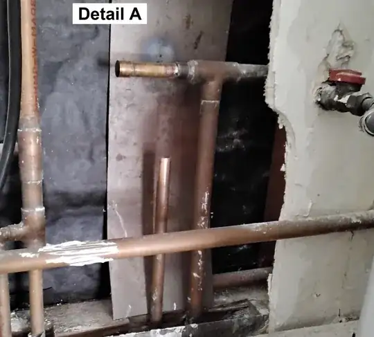

Detail A: This just shows how I disconnected the 1/2" pipe. I had a cap and pipe so I shoved it inside the reducer while heating the whole thing. It was really painless. It doesn't look pretty but I'll fix it later. I get the idea that there will be water trapped inside that will never move.

main
detail b
detail c
detail a

You should be fine drilling a hole. I see it all the time.
https://up.codes/s/drilling-and-notching-of-studs
Drilling. Any stud shall be permitted to be bored or drilled, provided that the diameter of the resulting hole is not more than 60 percent of the stud width, the edge of the hole is not more than 5/8 inch (16 mm) to the edge of the stud, and the hole is not located in the same section as a cut or notch. Studs located in exterior walls or bearing partitions drilled over 40 percent and up to 60 percent shall be doubled with not more than two successive doubled studs bored.
